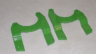

                    Somebody has done a write up on here somewhere about the rear Disc brake conversion, I have the Pics from the post of the mounting brackets
                    I'll go n find em ....
                    Jess
                    "cos short cuts can cost more in the long run"
                    Here ya go

                      The first thing to do is drop a gear or two before starting a long, steep descent - you need to understand is that you're driving a two ton truck which means that when you brake you're trying to dissipate a huge amount of energy so the 'kin brakes WILL get hot regardless of whether you uprate them !
                      Next - the FRONT brakes do most of the work so while fitting discs to the rear will help there are more cost effective ways of improving things.
                      1. Replace the brake fluid
                      2. Fit braided hoses
                      3. Refurbish/replace the calipers
                      4. Fit good quality pads
                      You could fit a larger master cylinder which will give more braking effort BUT you really need bigger discs and pads as well
                      You could also consider fitting the brakes off a Tundra - there's a thread about it on here somewhere but the search isn't picking it up. IIRC it means fitting 16" rims AND grinding a bit off them too.
