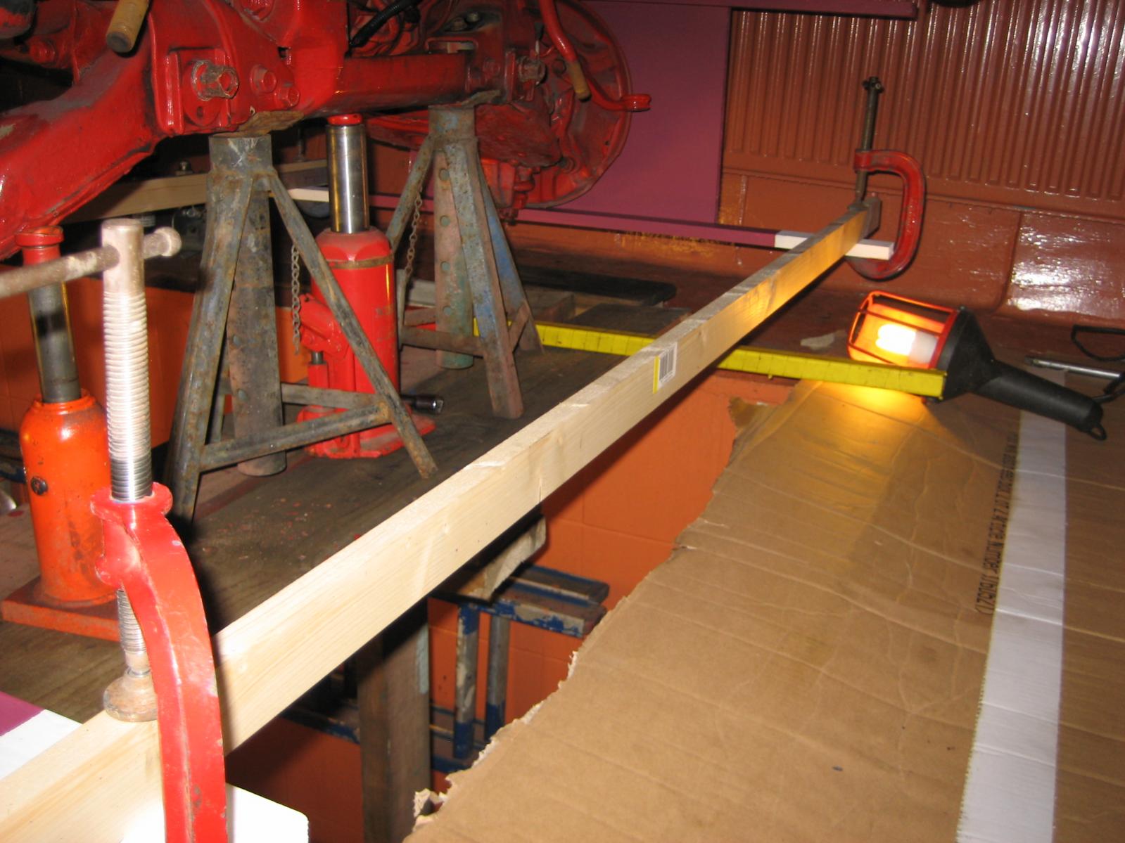

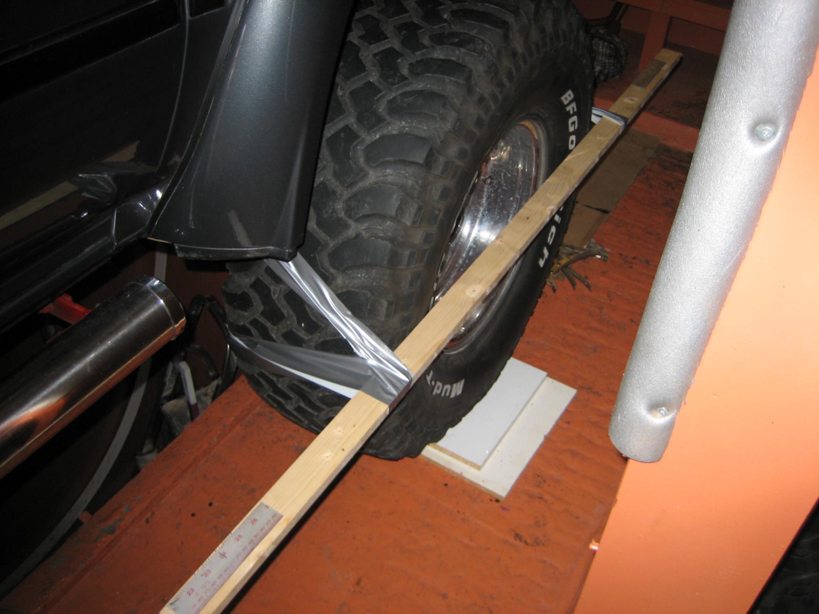

                when i did mine i removed both sides track rod ends, got the camber/castor about right then fitted 2 X 2mtr lenghts of straight batten to each wheel, measured fore and aft till both measurements were the same and adjusted the track rod ends so they just slotted back in the arms, final adjustment made after the rod nuts and split pins were refitted, this got both front wheels in lighn with each other but not in line with the rear ones, the guy in the vid used string but i didn't bother, it looked in line but in fact is slightly out so the truck "crabs" very very slightly, doesn't notice apart from the steering wheel is now "off center" i'll get round to doing it soon a i get some RSJ to jack on across the pit! *hint!!!
