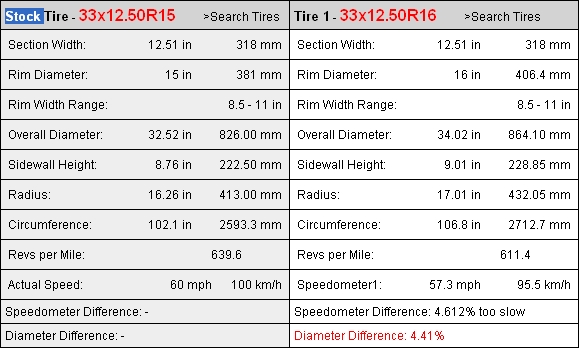

Here's the calculator -
http://www.1010tires.com/tiresizecalculator.asp

Okay so this must sort of explain why some 33" tyres fall short of 33".
I have just compared USA sized tyres - 33 x 12.5 x 15 and 33 x 12.5 x 16 and the 16" rim makes the tyre 34" and the 15" rim seems correct with a tyre of 32.5"
Strange. May be the USA sizes are just a rough guide to match to the imperial sizes? e.g. to try and make it easier
