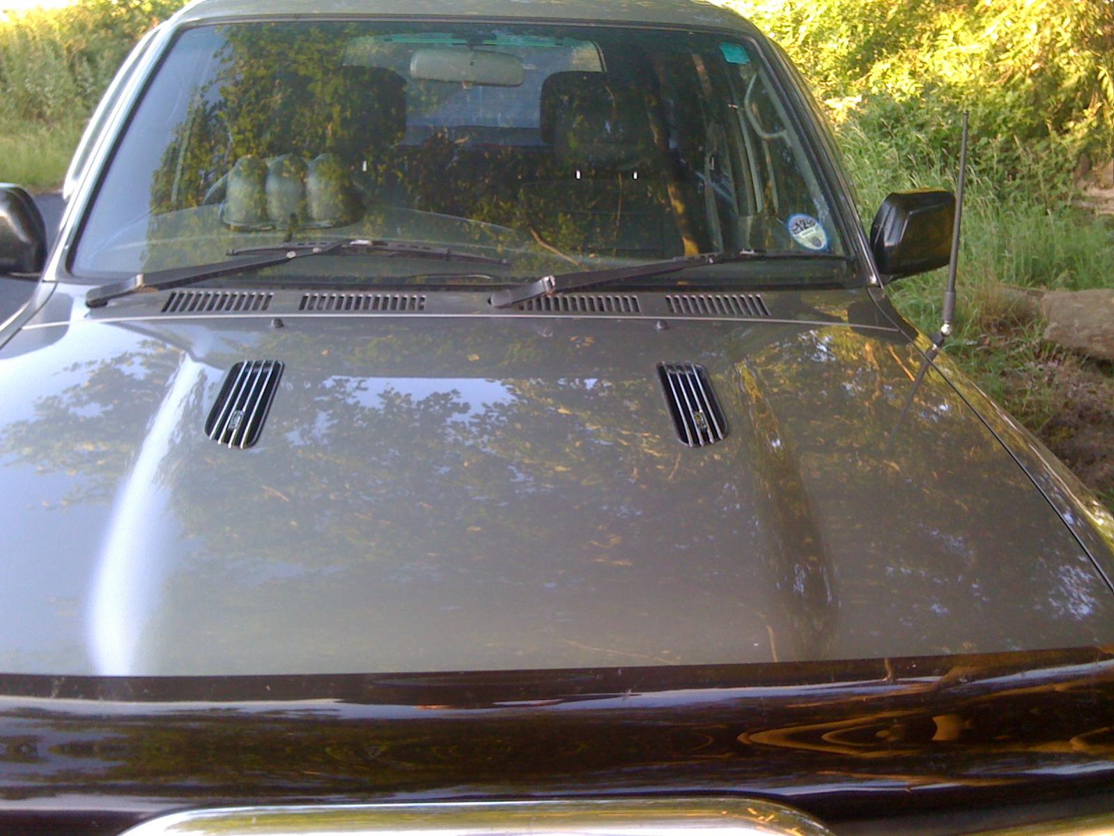

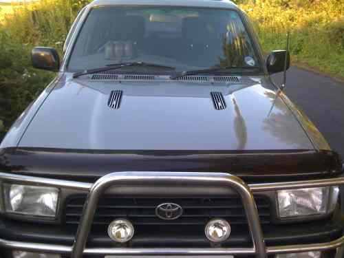

      Bonnet Vents
      You could fit an electric fan, much more efficient and i also added the vents to the bonnet to improve the air flow!
      Barron.
