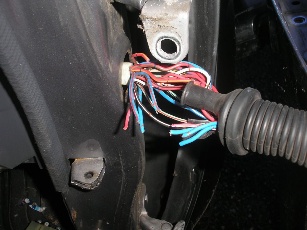

After taking the door to bits and checking the switches and the door motor no joy.
I took the bottom of the dash off and took out the Central locking relay checked for dry joints all seemed ok!
unplugged the door loom from the fuse box and central locking relay and pulled the loom back into the door and stripped it back to expose the wires to check them and what do i find??
Do you think that it could be my problem???
It's amazing what a few years of opening and closing doors will do to wires.
now start's the job of stripping them back and soldering it all back together
