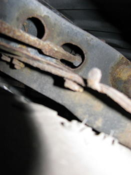

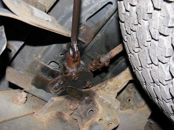

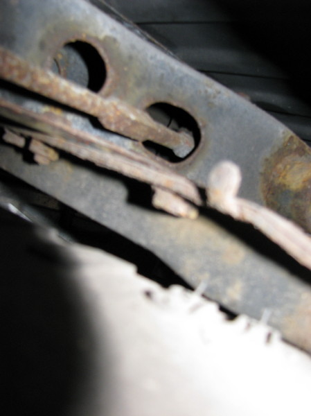

    I've taken a couple of photos of the spare tyre linkage that I now realise I have!
    Have grabbed axle lever and managed to locate it into socket but obviously the whole lot jammed! So please, which way to turn the wheel down? And can I hope to free by unwinding or do I have to go above the spare wheel and oil the linkage there?
    As I don't know what I'm up against I'd appreciate some help.
    THanks, Stewart
    There is usually a sticker on the bumper by the
    hole showing which way it goes .
    it's linked to a chain mechanisum that lower the spare,
    proberly a bit rusted up , like you have done spray
    with WD40 and try to unwind it, if I remember
    right it was anti clock to lower and clock to raise it .
    Chris
    GOT NO COWBOYS HERE?
      Clockwise = up
      Anti clockwise = down.
      It's attacted to a steel cable, and comes down like like the weight on the end of a crane.
      peace
      cal
      Bala Mud, best underseal there is, only £30 per application.
      www.thecellardwellers.co.uk
        A specialist penetrating (ooer!) dismantling oil is better than WD40. If you get your hands on something like PlusGas it'll work a treat. And hit things with a hammer too. The impact will help to free up seized bits too.
        (Don't forget to put a piece of wood in the way to save denting anything valuable!)
        As a last resort you can always try heating things too but I'm not too sure that lying next to the fuel tank firing a blow torch at stuff is something I'd be that keen to do!!

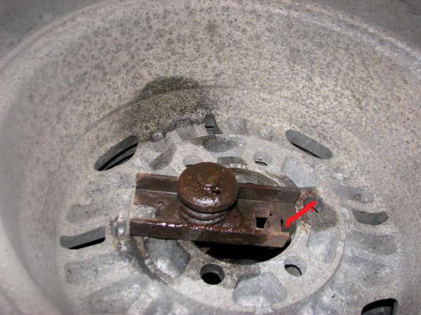

          Just Make sure when ya lower the wheel n before winding up (relocate the peg in the wheel) see pic
          Jess
          "Cos short cuts cost more in the long run"

            Thanks .. so it's squirt then twist then put a plug in it .... ta, I think I got it (Just got to make sure I do it anti-clockwise .....) eek!
