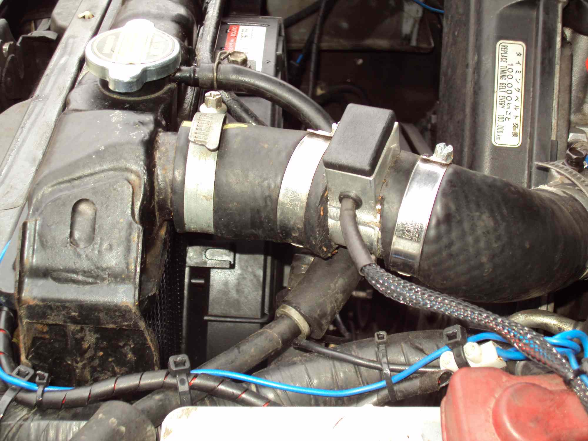

    Hi, fitted an aux temp electric tim gauge, I put the sender into the top rad hose with an adaptor, has anyone else got one? the reason I ask is I went for a drive today and the temp moved the whole time every time I accelerated or slowed down from 40 up to 80. I realise that when I accelerate the water pump pushes the water round faster just want to make sure as it was dropping right down to 40 when I drifted to a stop.. Is this normal? Thanks for replys...
    Doesn't sound right - my Tim gauge sits bang on 85 degrees unless I'm booting down the motorway or going up a hill..
    Maybe you have some air in the system ?
    Why did you fit it in the top hose when you can fit the proper sender in the thermostat housing ?
    Rob.

        Thanks Rob, I wanted to have it to compare to the stock one so thought I would put it in the hose as an indication or the stat opening as well. I think my problem might be that I took the live feed off a wire behind the gauges, Im thinking that it might be getting a diffrent voltage when Im accelerating, you've confirmed my suspition and I'll change the live feed and that should fix it. Cheers mate

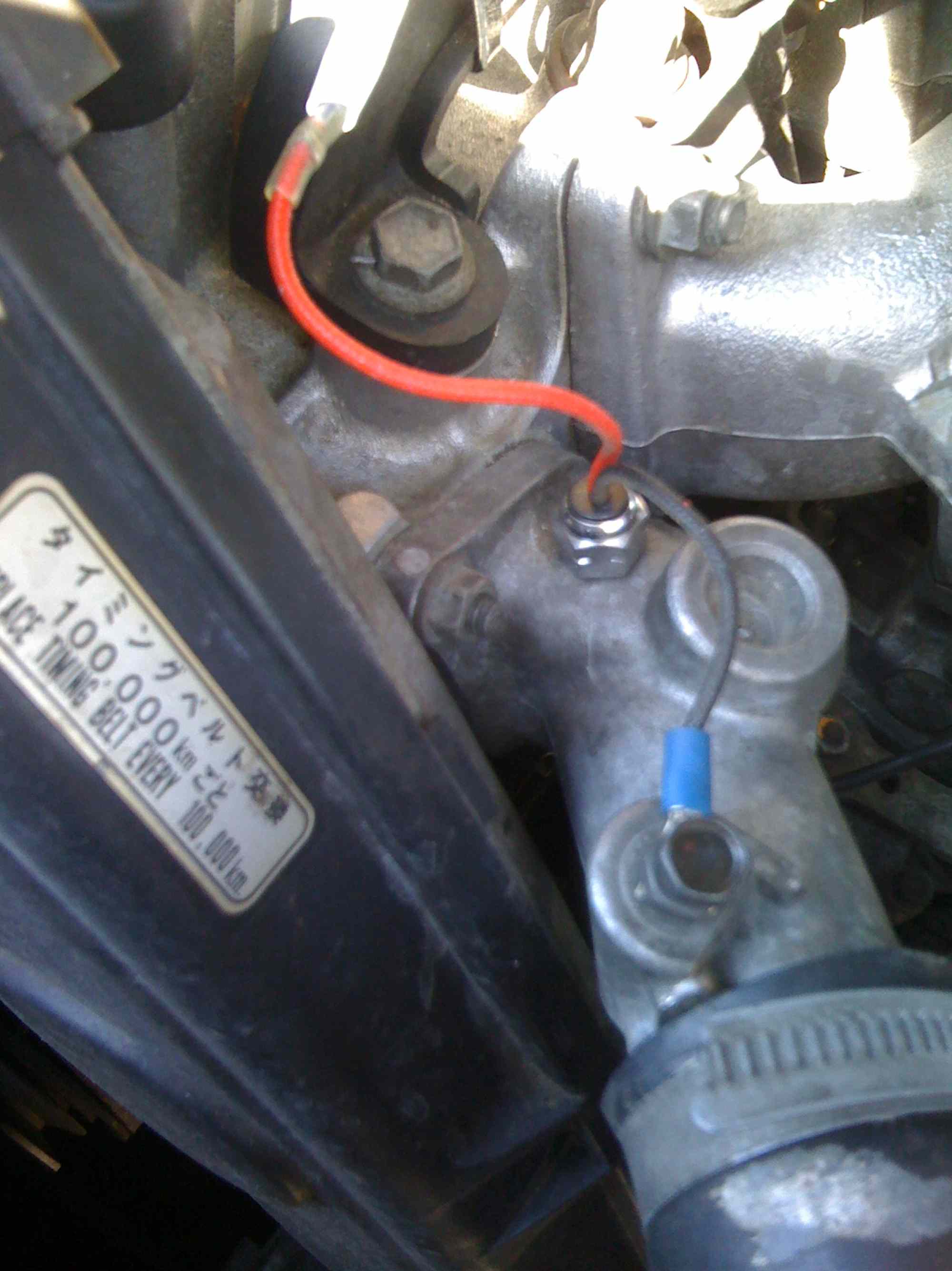

              Hi, you could drill and tap to fit the sender in the outlet from the head to the block like this on my KZN130.The unit in the top hose is the thermostatic fan and electric water pump controller.
              Regards,
              Barron
                Regards,
                Barron

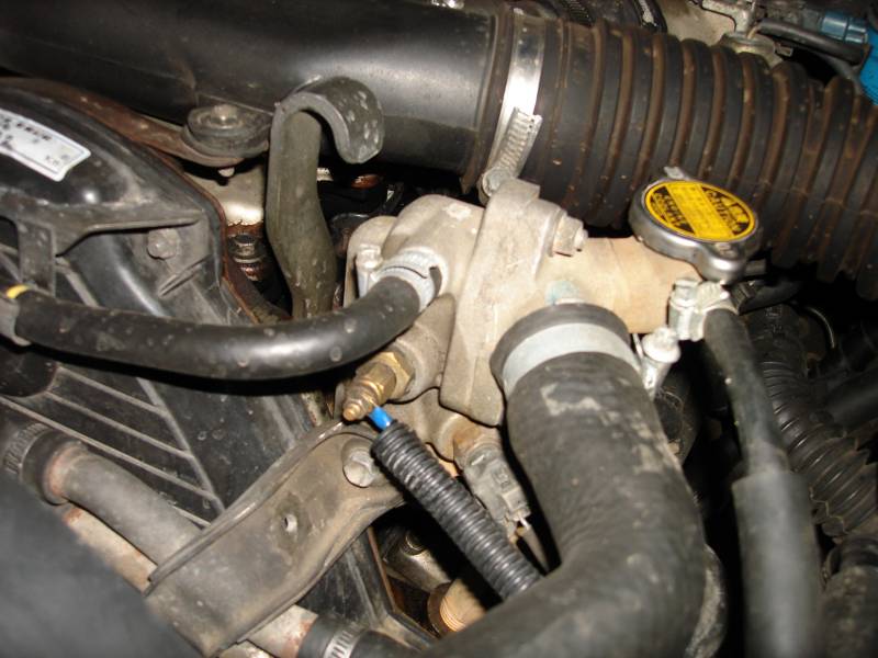

                No need on the 2.4 - it has a blanked off hole in the thermostat housing. Just remove the bolt and screw in the aux sender.
                  Thanks for pointing that out, makes it so easy to do!!
                    Because he has a manual. They do not have the blanking plug in the housing, only autos do.

                        I fitted my water temp gauge sender in the top hose as well, it stays at zero till the stat opens and then gradually creeps up, take a feed from an ignition source and dont forget to "earth" the sender, mines been in for over 3 years an always ok,
                          Nev
                          Makes sense - I forgot that the manual is different.
