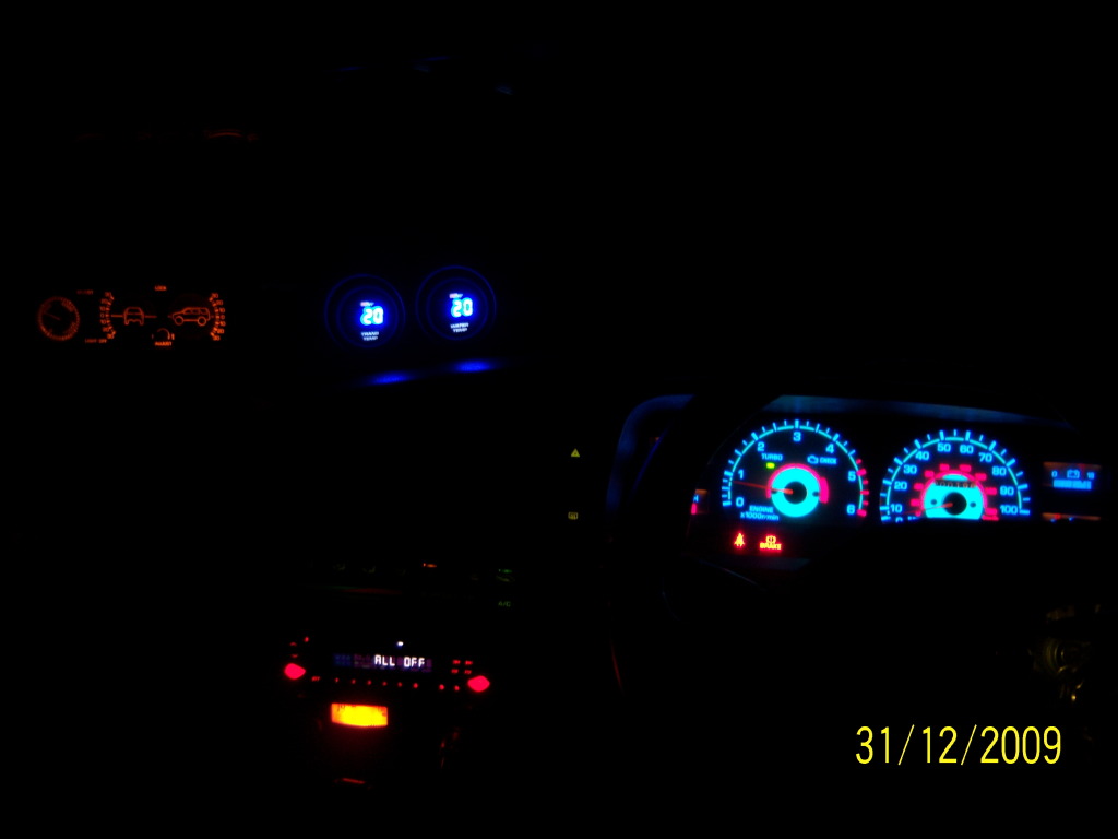

          here is mine i like the digital guages! i have atf on the left and water temp on the right. they are a bit on the bright side when driving at night.
            Looks very good mate, i fitted some didgital temp gauges for the veg oil tank they are nice, those indiglo dials do looks the dogs, i should have gone for them instead of buggering about sticking a couple of thousand led's in there, you need my heater controlls lighting upgrade in there!!

              yeah that looks good! did i see a write up somewhere on how to do that??
                may have been mine i think i did post it, anyway aint too hard to do but it means removeing the unit from the dash which is a pain, or mayby try contacting our old friend Rod Leach, i made one up for him once but he never fitted it (shows how impressed he was with it) then ya could just swop em over plus run a panel lights feed and neg,
                when i was more enthusiastic i upgraded all the interior lights and switches, dunno why toyota bothered with some of the switch lights, dam near invisable unless its pitch black, i had the truck best part of a year before i noticed the drivers door master switchs had lights in em
