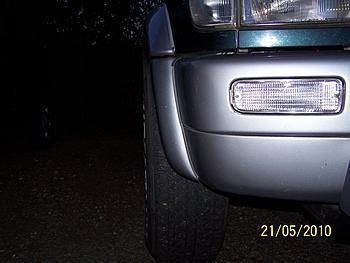

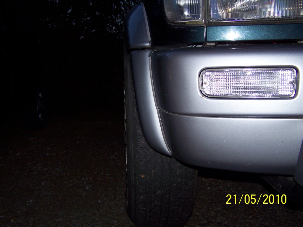

            I've fitted the RT ones and had no problems yet, spacer nuts and wheel nuts torqued to 85ft/lbs, (as Albanach says) checked every two weeks although thus far they have not come undone at all, put copper slip on both the threads for the hub studs and spacers studs and also between spacer and hub and spacer and wheel.
            These are the closest before and after pics I can get, didn't really take a proper pic before fitting them.
