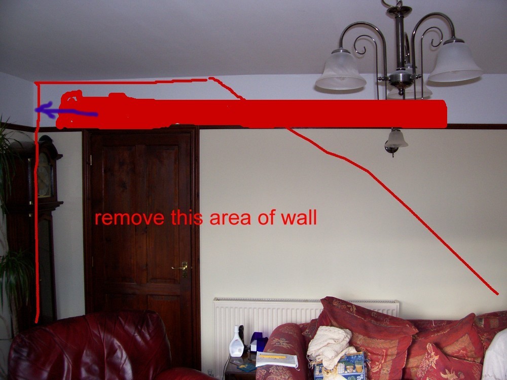

Splendid. Yes, is looks like the stairs are self-supporting. Just check that they are not on hangars fixed to the wall before you can be 100%
A catnic as shown would do the job. You would need to acrow prop the joist whilst you get the catnic in place. You just need to select the right size of catnic - if you don't want to get an engineer involved, building control will probably give you free advice on the load.
