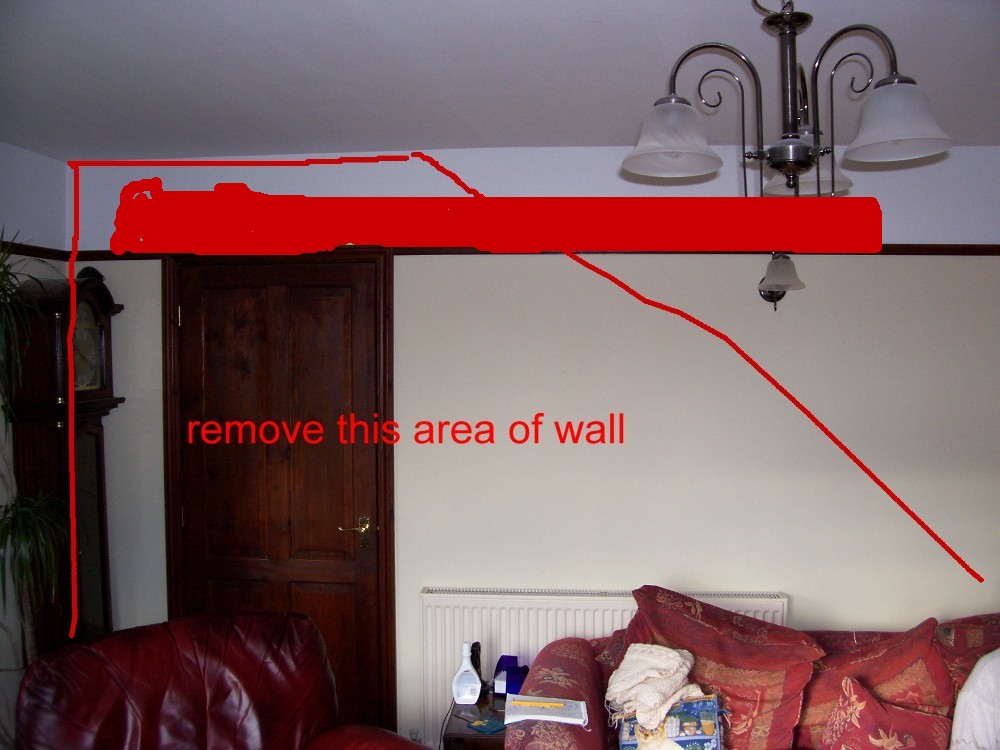

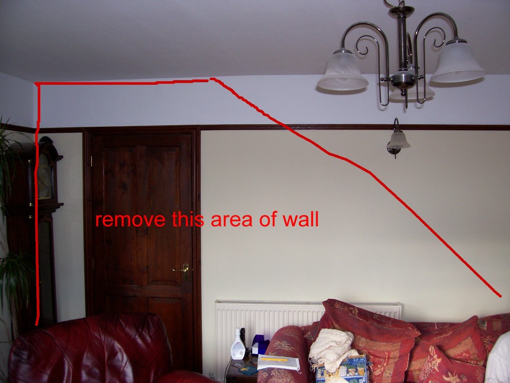

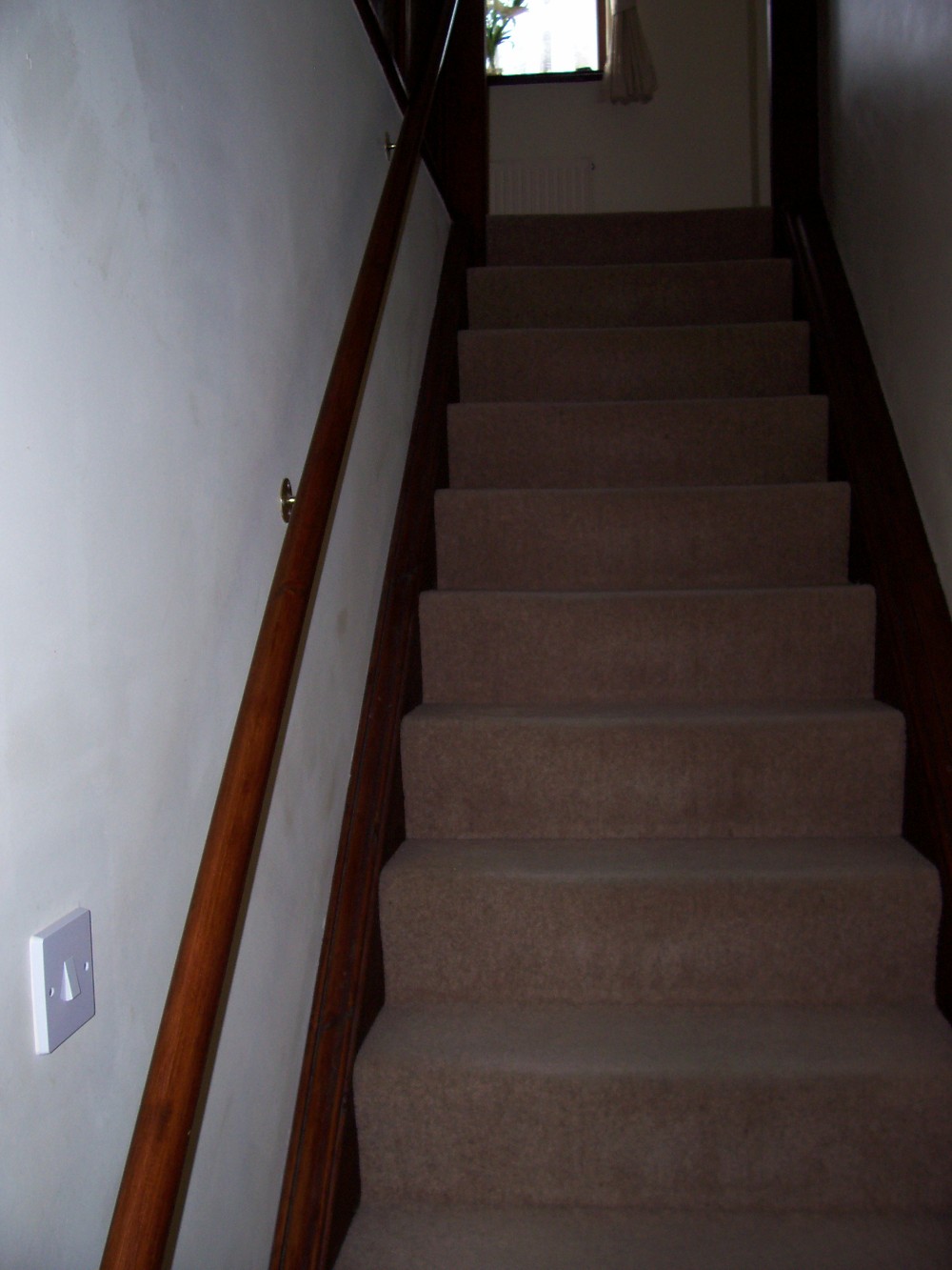

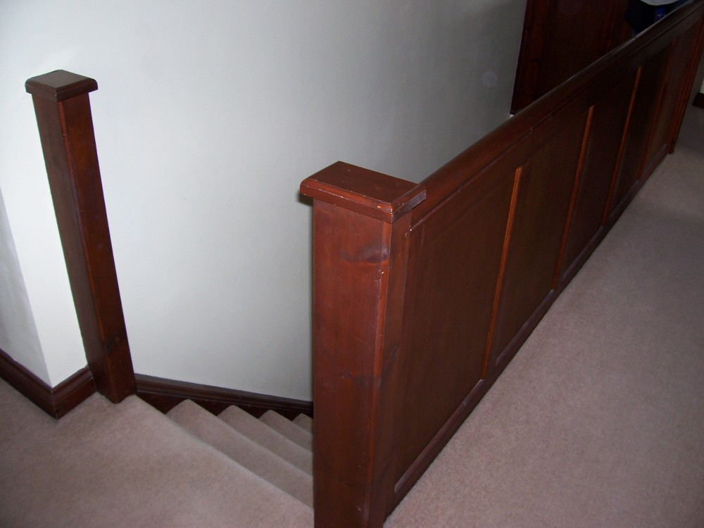

                    Some pics , I hope , to help .
                    1st pic is the room with area of wall I want to remove
                    2nd pic is the stair case behind the wall . The wall to be removed is to the left of stairs
                    3rd pic is top landing with the wall area beneath the wood paneling

                      Have you got one from inside the cupboard to show how the stairs are fixed on either side?
                        The underside of stairs is plastered in .
                          Bum. In all likelihood, they're sitting on top of that wall for support. I don't think you have a problem supporting the upper floor as you will be able to stick a catnic in there to make the size of opening you're talking about. Your problem is in supporting the stairs.
                          Stairs obviously have very little load on them in the great scheme of things, so I would suggest a decent builder can come up with a solution (probably a timber joist running diagonally) with no great dramas.

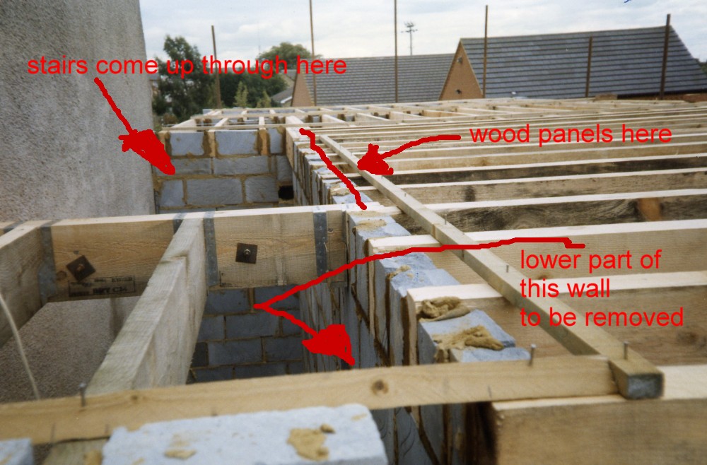

                            Got this from building photos taken by the builder. As you can see the wll does support the floor joists . I think the stairs bolt onto the 2 bolts shown in the pic and are not supported by the wall.
                              I thought of cutting in a catnic or lintel here
