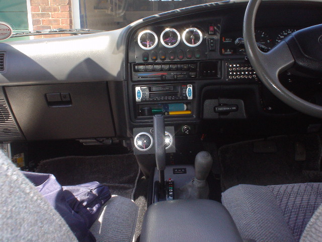

      This is nicer though.
      You got any more pictures of that?
        That's wicked!!
        Could you post some more pictures of it from some different angles?
        What do you have mounted next to the gauges? CB? Radio?

          this is exactly what i wanted to do, except add a couple more gauges. what did you make yours out of? I also like where you put your CB, i'm thinking of doing the same thing after i get my gauges installed. i don't want to loose my vents either, it gets way to cold up here to go with no heat.
          Taped off the centre console and bottom / rear of dash. Applied 4 layers of fibreglass and resin. Cut to fit. Added 3mm hardboard sides, 6mm ply front and trimmed in vinyl (taken from old door cards) and black leather for the front.

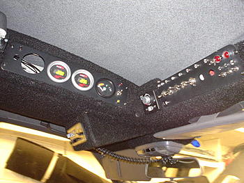

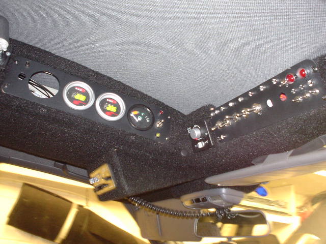

            Here's my 10 cents worth! who needs center dash vents and that naf cup holder? strictly for pussy's
                  Ian did ya wanna be a Pilot or an Alien when ya grew up ??
                        So, Popeye, do you like the new batmobile???
