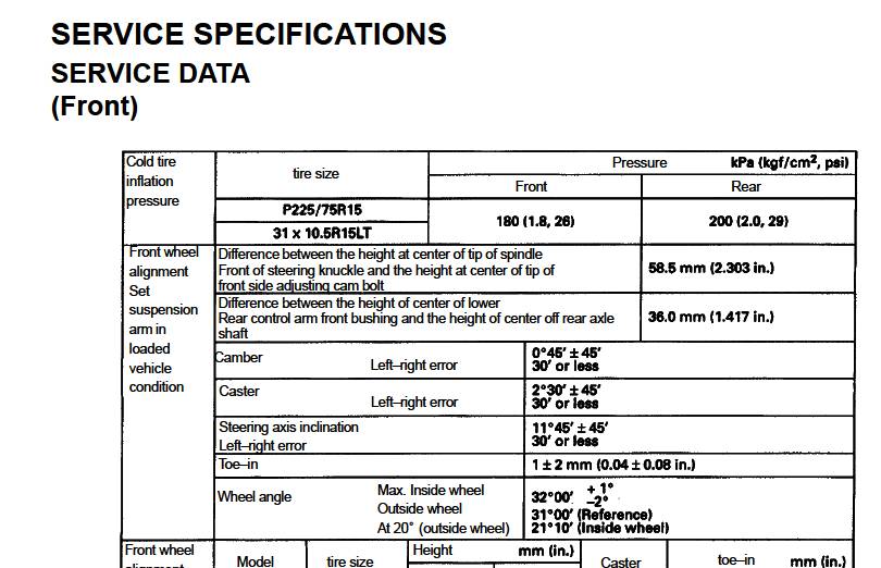

    Been flicking through the US 4runner manual. States that 31" x 10.5 tyres should be 26 front, 29 rear.
    A fair bit lower in the front than most seem to run here ( ~30 - 32 )
    Shame it doesn't give loaded or m'way pressures....
    Rob.
    33psi always, never a problem what ever speed/weather. (GG a/t's)
      What made me think about this was when I had my GG at's swapped onto my rims... They stuck in around 36 lb's and the truck felt terrible. Really skittish and hard. I dropped them back to 30 after searching here and it felt much better..
      I only came across this info as I'm getting an alignment done and needed the official info to take with me in case they play up there.
      I'm going to drop my tyres down to these pressures tomorrow and see how it feels. - got to set the torsion bars perfect before the alignment so will be interesting to see how the ride feels.
      Rob.

                Tried the 26psi thing today and it didn't feel too great....
                Going back to 30 I think.
                Rob.
