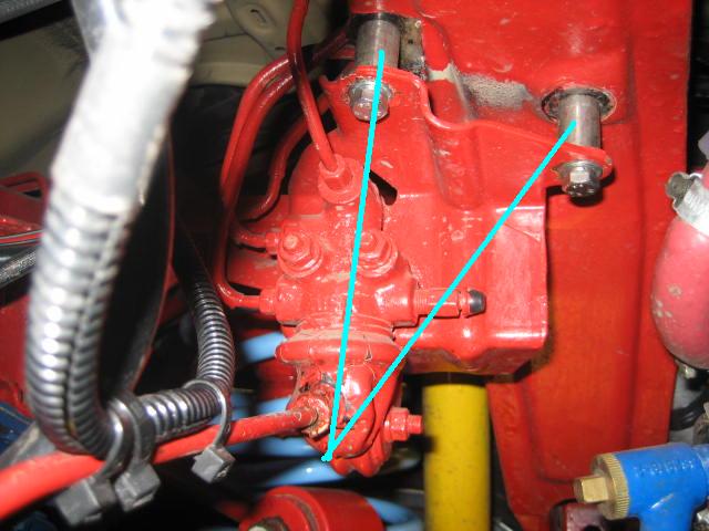

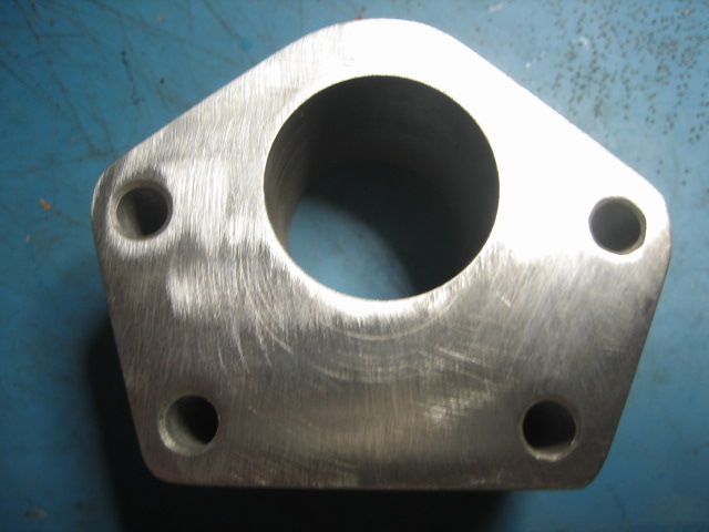

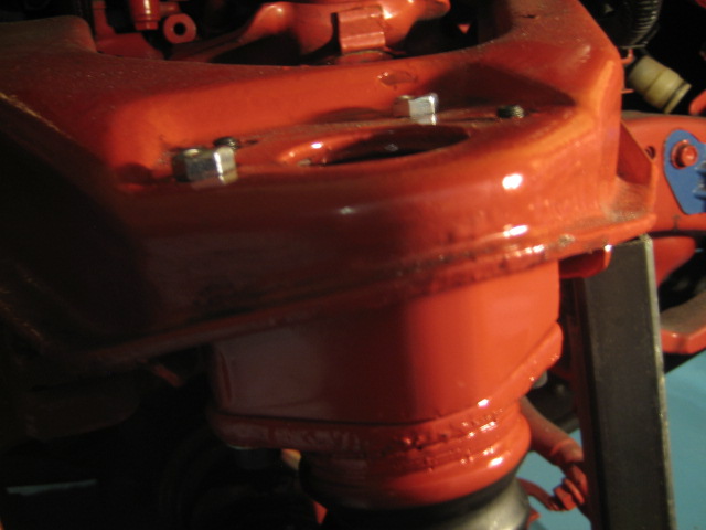

              What your planning to do is exactly what i've done, it'll be much better on a 3lt tho...
              Thanks for the detailed reply... if you could it will be nice to have a look at the photo's that you've taken while you were doing it
              All I want for X-mas is a garage stocked with tools and a manual 3.0td Surf
              • #82

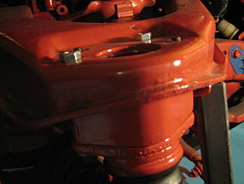

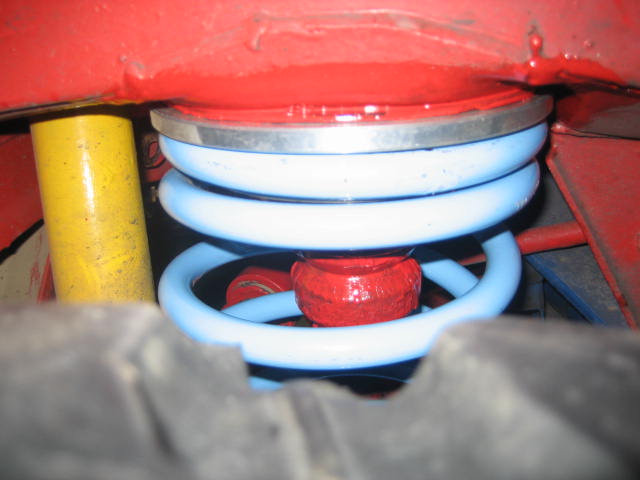

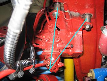

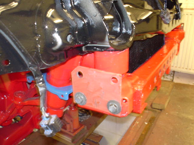

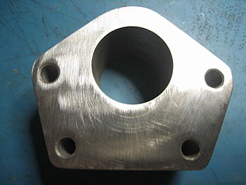

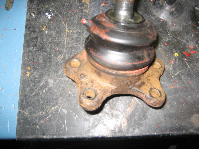

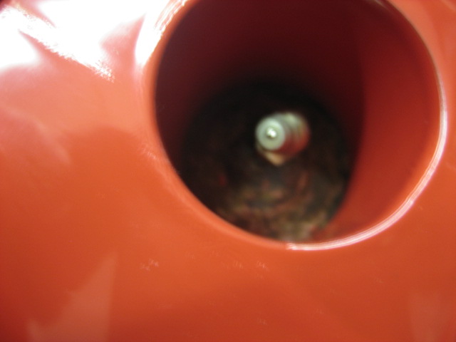

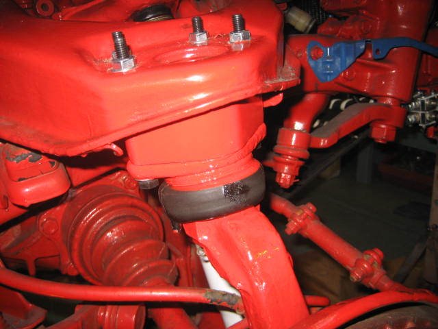

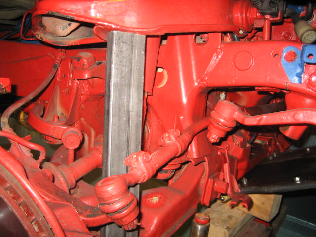

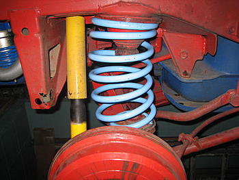

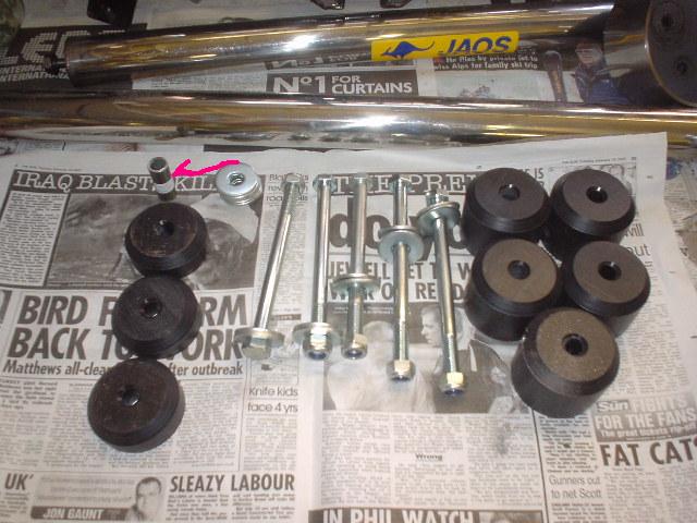

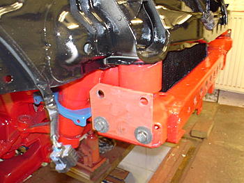

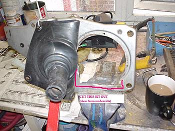

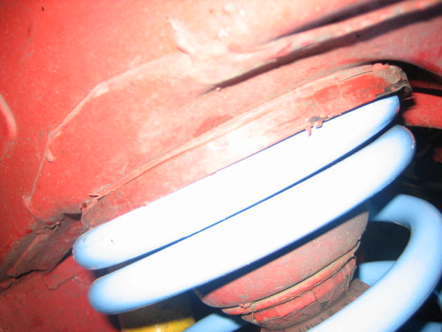

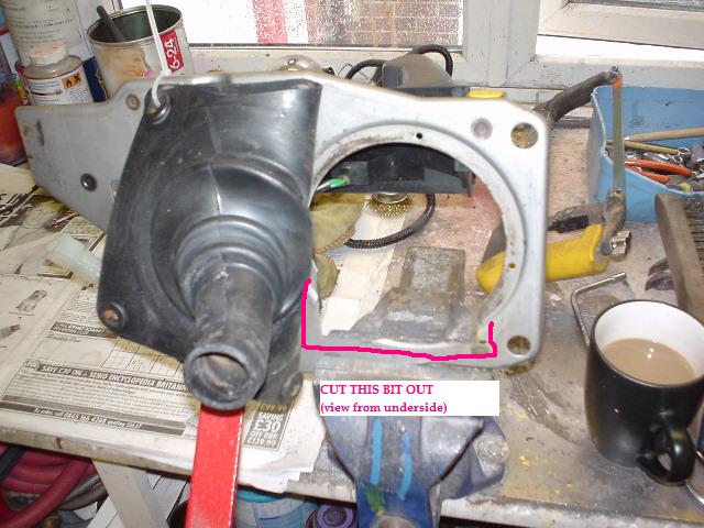

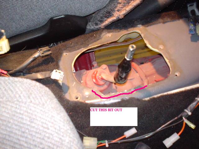

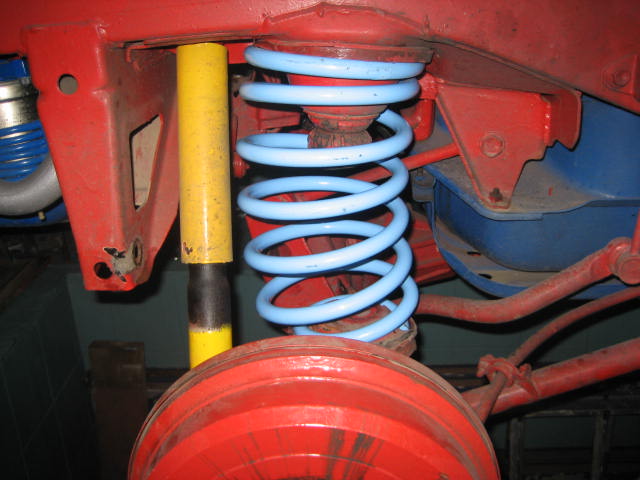

                A random few, first two are where to cut the tunnel and plate,
                the ball joint space and where the grease nipple will be when done, the box metal to hold up the top wishbone, and the rear spring without and with the alloy seating ring, got some of body mounts but not much use to you, you'll soon find em, two at the front six inside the cab (three each side) and to in the boot near the luggage anchor eyes, except for the front two they all have plactic covers over the bolt and the bolt heads have fixed tab washers but they come unfixed pretty quich so you'll need a locked socket inside while you undo the nuts underneath, bolts also very in size at the different mounts so keep a check on which ones go where, you'll get the right size blocks and bolts with the kit, i got mine from stien and they were 4" blocks which i had to cut down and over thickness bolts meaning i had to ream out the steel inserts/washers etc, you should'nt have that prob tho, theres a pic of the spacers i used to drop the rear break compensator assembly down a bit to take the tension out the hose as well, plus bumper lift bracket
