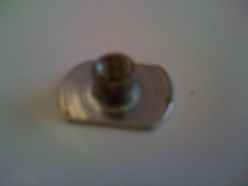

c'mon then all you clever hardware/tradesman/people people. What are these called, or better still where can i get a few from?
what are these
Not sure but prob come under the heading of "fastners" thought they were
rivnut type fittings at first (and may well be) but the nut looks to be welded on the plate, email an attachment photo to screwfix or similar and see what they say,
Just thought, i have a few similar ones called "bigheads" male and female if there any use, i'll stick a pic up tomorrow if you think they'll do,Last edited by POPEYE; 1 April 2009, 19:20.Too young to die and too old to give a toss
They look a lot like the studs that were used for fastening the hood down on my MGB, so if you do no good at a chandlers try MG owners club.They have thier own shop but I would try a canopy maker or chandlers first.Originally posted by greecysurf View PostHi, you can get them from a good marine canopy maker, i have about 20 of the screw in type if you want them.I've taken a vow of poverty To anoy me send money
Originally posted by Brummie View PostThey look a lot like the studs that were used for fastening the hood down on my MGB, so if you do no good at a chandlers try MG owners club.They have thier own shop but I would try a canopy maker or chandlers first.
Think you may be refering to "lift the dot" fasteners, if so it's not them, we use LtD all the time.

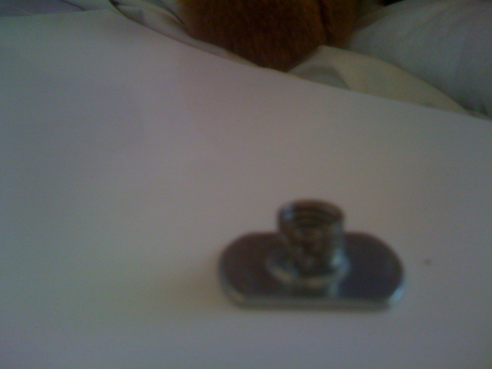

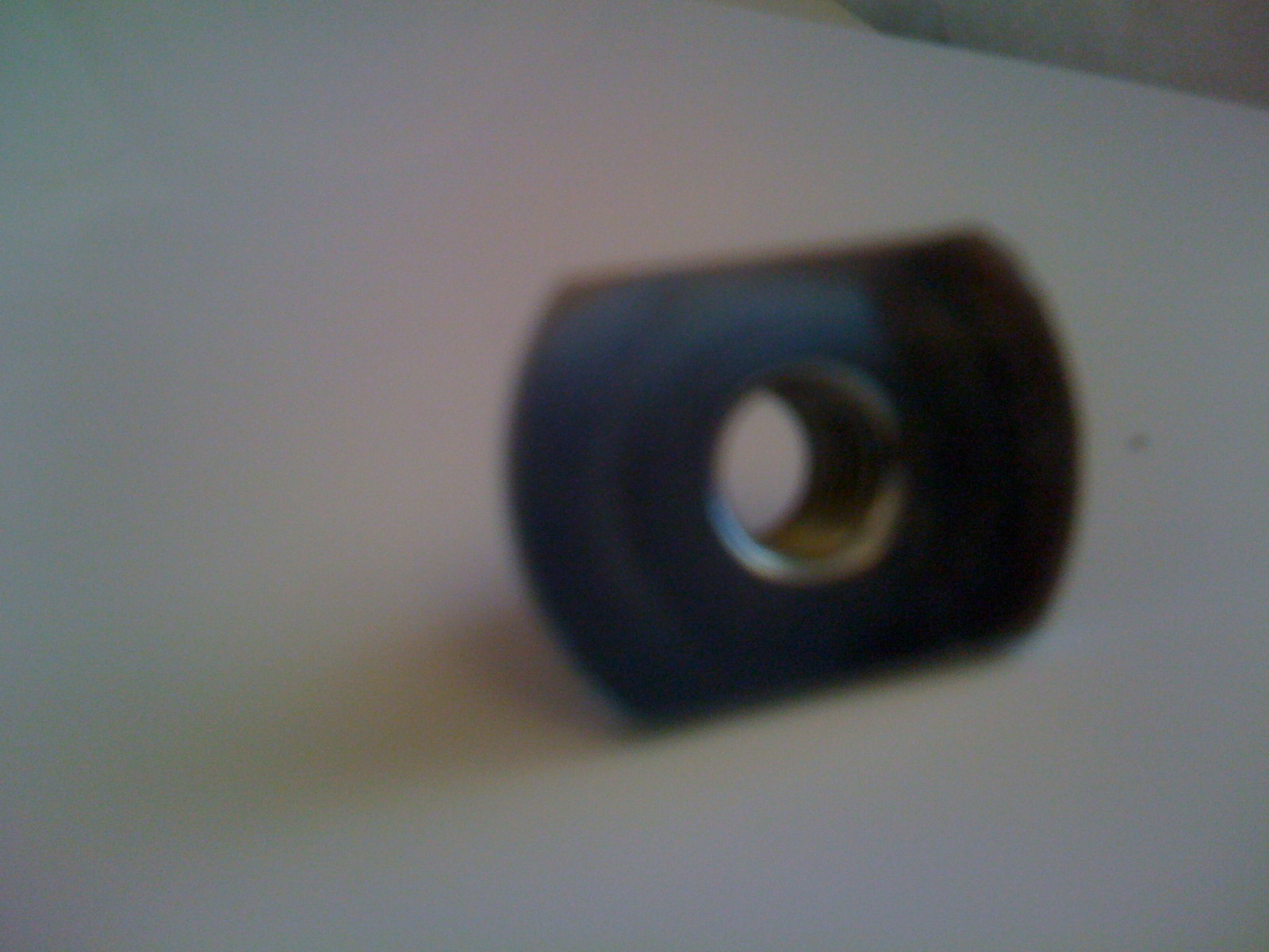

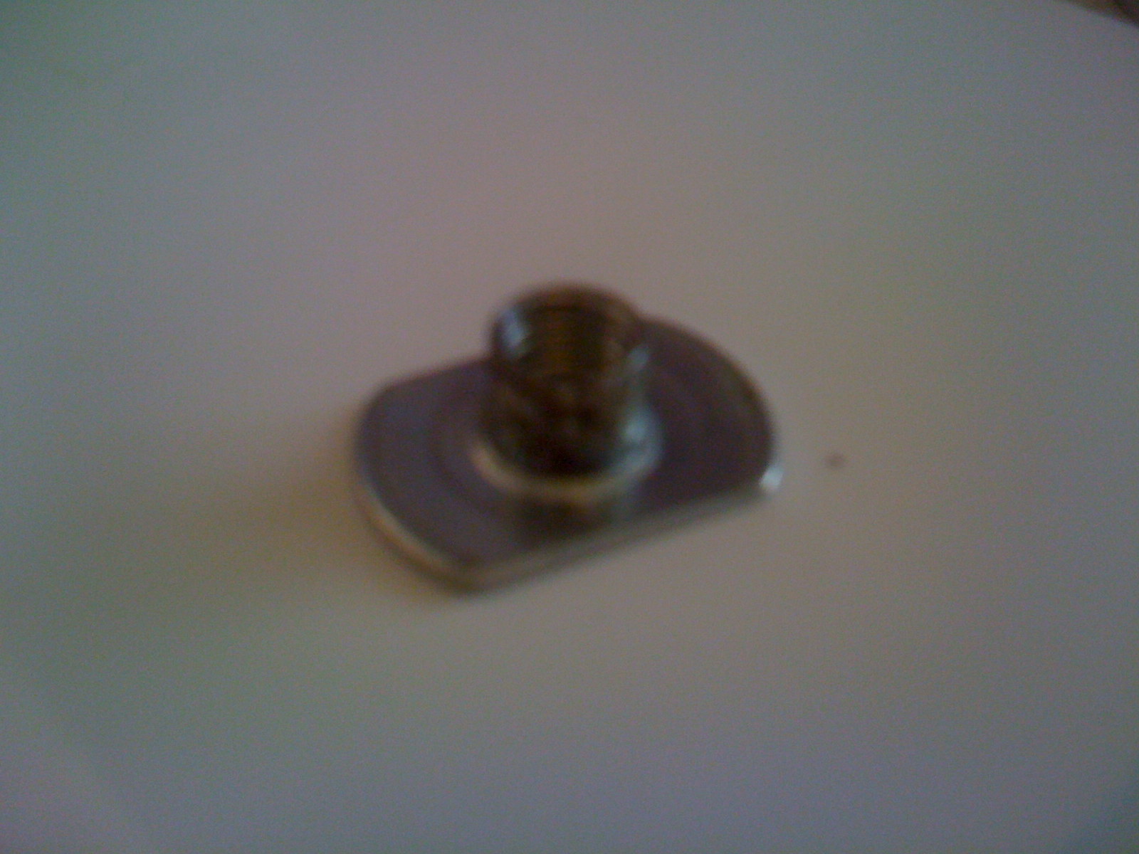

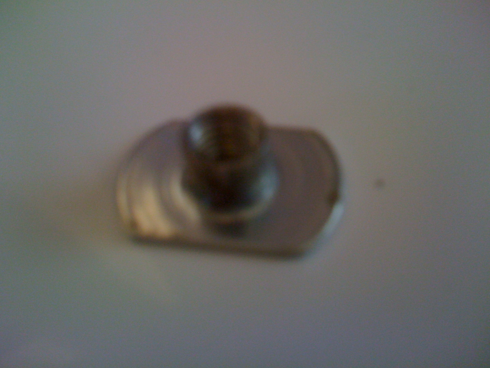

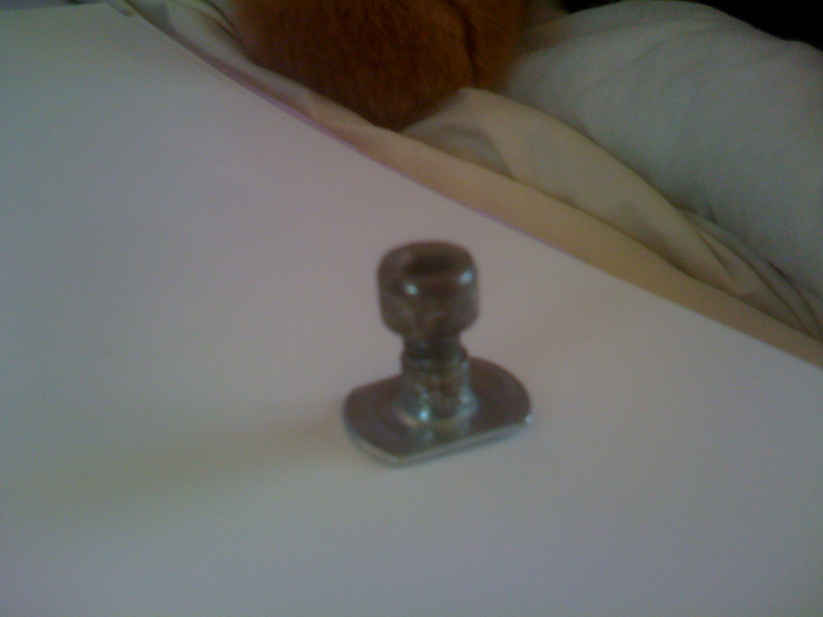

What are they used for and do you have better images, they're a bit (lot) blurred my end.
Rod
sorry yeah, didn't realise the pictures were quite that bad.
They're basically a flat plate with a bit of tube on threaded internally. the plate is about 1" long, by 3/4" wide, and approx 1 mm thick. The thread is something around m8.
What it does, well it's part of a bikerack. There's like two bits of thinwall box section, one slides inside the other, to make a kinda telescopic/adjustable type affair so you can adjust the overall length to suit different size bikes. The outer bit of box has a hole drilled through, and the plate bit goes inside the box, and the tube bit sticks out through the hole. Then when the other bit of box is in place, you can screw the allen bolt right the way through the tube to push against the inner bit of box and hold the whole lot in place, if that makes any sense.
It's a kinda backwards captive nut, but with threaded tube rather than a traditional hex nut or square nut=========
