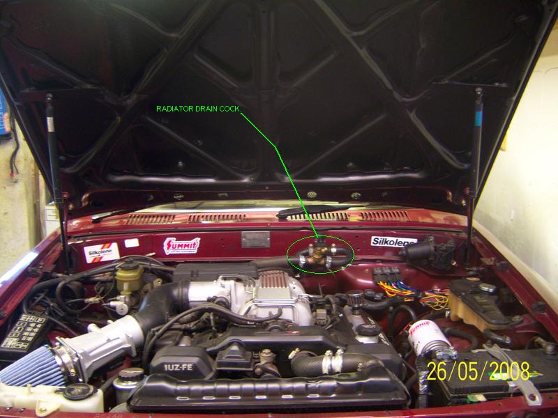

          i followed the mattf/popeye route off putting a t piece up by the heater control (the one on the bulk head) and hanging a litre bottle of coolant to drain in to the system, i still had to leave it parked uphill with the rad cap off.it took about 3 good runs/cool downs to finally settle down, and i have to do a good 10 mile run at least before the bottom of the rad gets hot
                    lLike this.......

                      @Bush....nice one. Looks like I'll be doing another job on the truck tomorrow!
