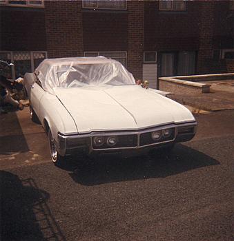

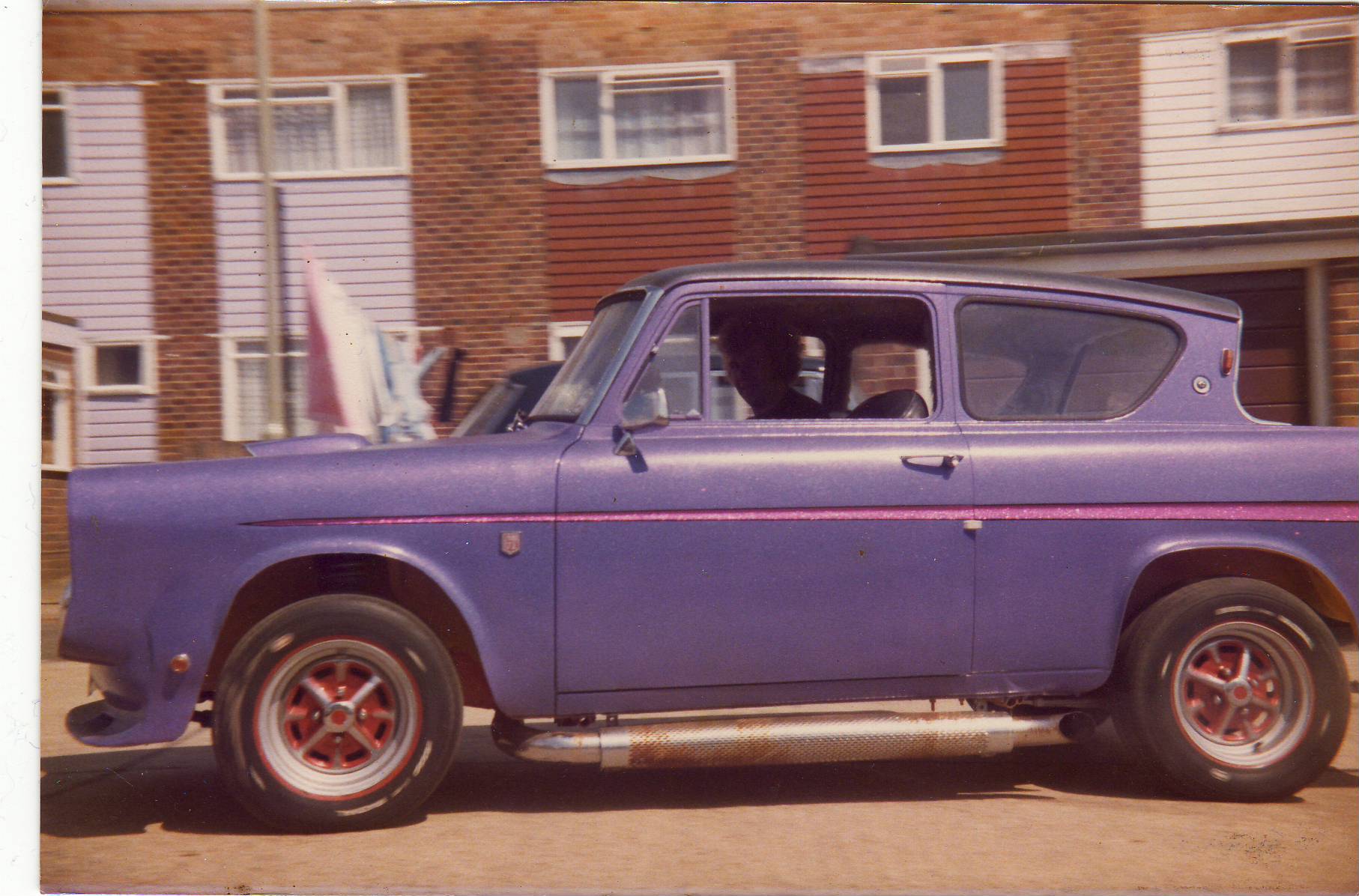

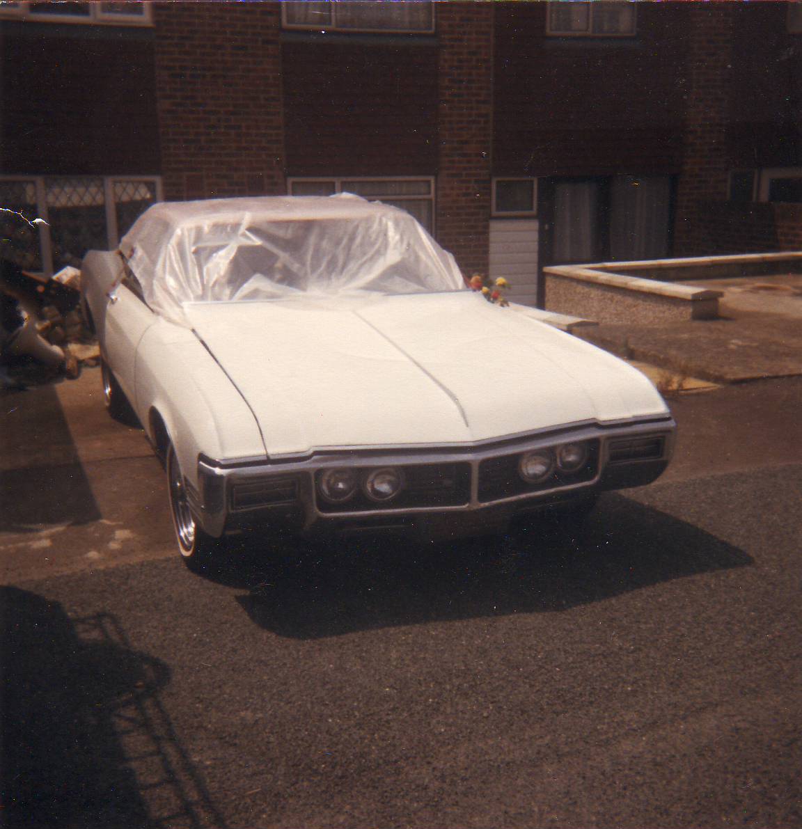

            Only pic's i have dose'nt show the flake/colour up, it just looks white, it was one of the "metalflake" range of flake powders (still have a bit of it i think) it's looks like course white powder but when sunlight shines on it it give of blue and green, they did several flakes like that of verious colours along with coloured flake and other types, cracked ice, crinkle, and the metalic "candy apple" colours, all the rage once, did the old ford fandango in blue/red flake called firebrand, with cracked ice (black) over bright red/orange side flash
            the idea with the buick was it should look like a plain white car till the sun caught it, much like that effect they do now at mega bucks a pint
            took some painting mate, three coats of grey primer, wet &dry between each coat, three base white coats, rub between each, five clear with flake added, to build up the effect, no rub down, then the laquer, ten coats then light rub with very fine grade and soap, then two coats with a rub between till it's got 30 plus and the depth is good, a f##k sight easier now with the two pack laquers, ya's only need 4-5 coats for the same depth, and if you got an oven well the sky's the limit, when we gonna see some of your work Andy? always fancied haveing a go at some flames

                      hehe he's dead right about the fuel consumption, i managed about 9 to the gallon and a bit better on a run (motorway) but i was earning then, plumbing like mad in some bad winters, spent a bl00dy fortune on that car, in the pic i've only painter the doors, front wings and hood, they came off and i did em in the garage, the arse end i had to do outside under a polythene awning with the sides covered in, what a bstd, little flys would land on the wet laquer, just had to wait for it to harden and rub em out. i did the top in blue vinal, a local bloke made it up for me, machine stitched into three pieces, looked nice when it was finished, then the motor blew up, rings went through two pistons and i gave up
