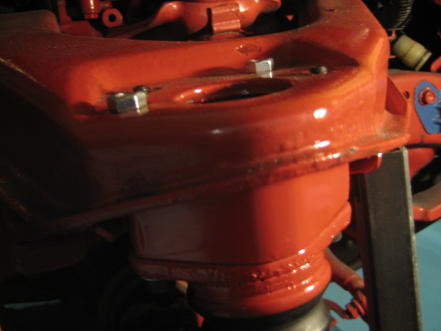

    All set to day to fit the spacers and the bolts aint quite long enough, i'm going to need M8 X 85, the ones roy kindly sent me are 75 and as you can see from the pic theres just enough thread pokeing through to get a turn on the nut without a washer, it wont take at all with a washer on, so if anyone can supply some i'd be more than happy to pay for em + post etc, i've been on yell .com and the pages looking for a local supplyer but no joy so far, they need to be high tensile (10.9 ish) or if anyone finds a link before i do perhaps you'd post it for me,
    ground off part of the controll arm so the spacer fits snugly in there, it was going so well too, bugger it

            The 75mm bolts would have fitted, its the 10mm thick paint that is the problem,

                    Thanks Dave but just ordered em, should have revisited this thread first, at least i hope i ordered a box of 25 and not one bolt on it's jack, got the M8X90's better to have em a bit longer than not long enough,
                    prob not far wrong Roy, fair bit of paint on there, i dipped em in the tin several times, could'nt be arsed brushing it on,
                    well got the bj back together and shock off, when the bolts arrive all i need do is tap the short ones out one at a time and insert the new ones,
                    It'll give ya 2" lift Jim! (i think i'm right in saying) if you use 2" spacers, although you do have to angle grind some metal off the back of the controll arm, it fouls the 2" spacer at the back, easy peasy tho
