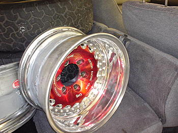

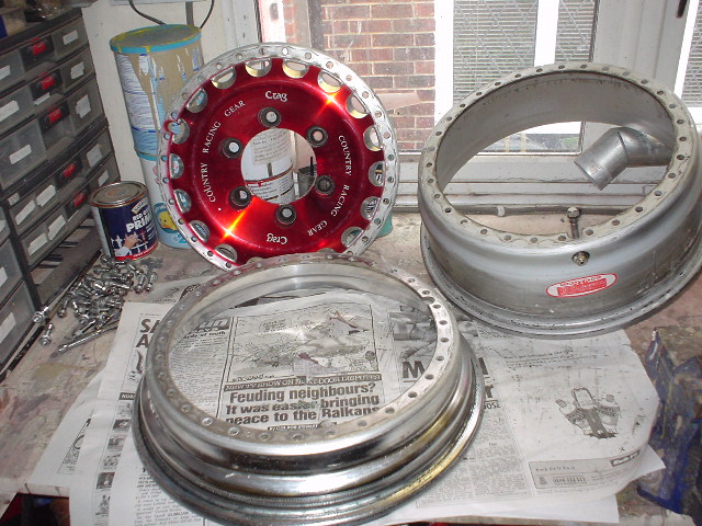

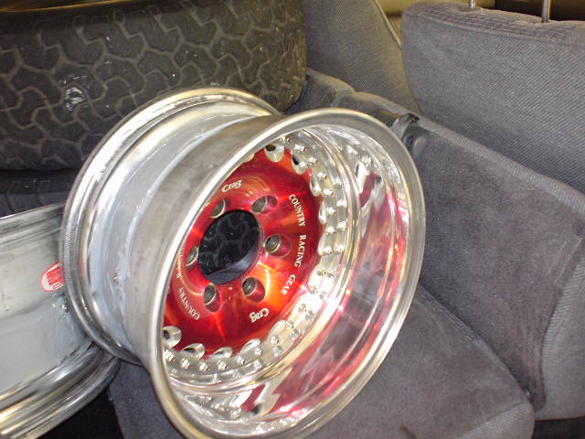

This is wot i mean, ya can only do it with two or three piece split rims, basicly turn the center spider round, it make the rims stick out further and increases the arc of turn, this reduces the clearance between the tyre edge and the arch, i only have a 2" body lift so i'm hope to crank the torsion bars about an inch and possibly fit joint spacers 1",(got to find out about that yet, so prepair yaselves for some questions
) wont ba able to tell till i have the tyres on the rims and start fiddleing, backends no problem,
Last edited by POPEYE; 4 November 2008, 15:36.Too young to die and too old to give a toss
Ooooh, now I've got my old wheels back of Joker (same basic design as yours), when I change the tyres I might just do that Ian! How did the sealant hold up and what did you use?Originally posted by POPEYE View PostThis is wot i mean, ya can only do it with two or three piece split rims, basicly turn the center spider round, it make the rims stick out further and increases the arc of turn, this reduces the clearance between the tyre edge and the arch, i only have a 2" body lift so i'm hope to crank the torsion bars about an inch and possibly fit joint spacers 1",(got to find out about that yet, so prepair yaselves for some questions
) wont ba able to tell till i have the tyres on the rims and start fiddleing, backends no problem,Cutting steps in the roof of the world
