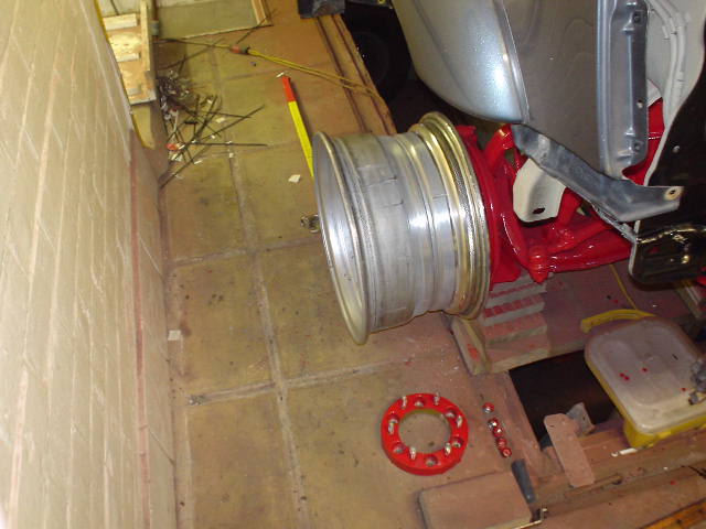

              post a pic up of the wheel and tyre! Should be able to tell from that.

                i await the wheel porn

                      My dear Watson, Listen up. That wheel spacer has holes with a PCD of 137mm. That means its got an o.d of not much over 150mm or 6". I therefore deduce that the tile its sitting on is a standard 12" tile. Looking at the wheel against the tile I,d have to say that, provided no trick photography has taken place, that My dear Watson is a 10" wheel. Its elementary.

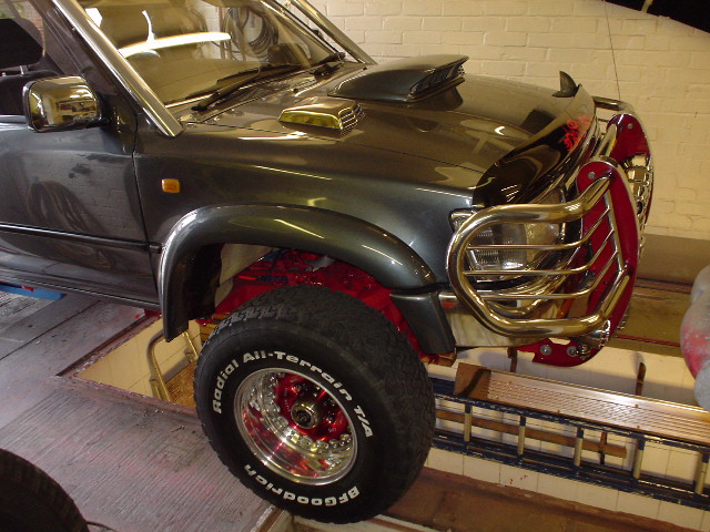

                        Ian, just looking at your hood scoop and bug deflector on the bonnet, It looks as though the intercooler is not getting the full force of air 'cos it's being deflected over it.
                        Just a thought.
                            Elementry my dear Bogus except the "tile" is a patio slab (bout 18" i fink) but yes i'm sure their 10" rims,
                            Vince! ti dont go fast enough to cause air flow
