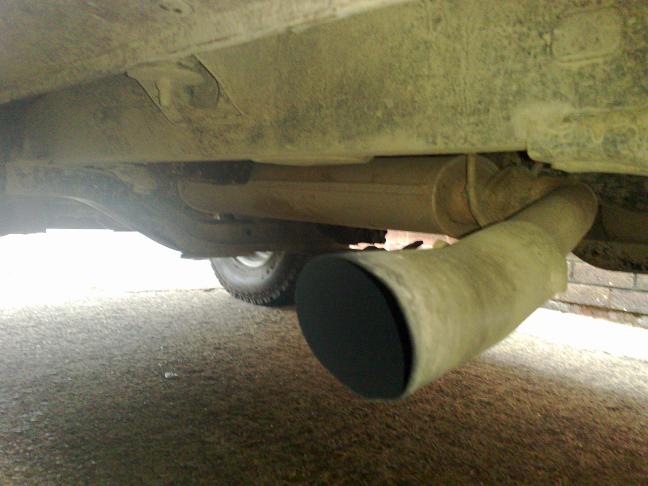

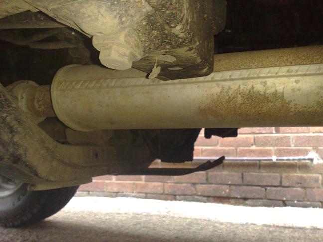

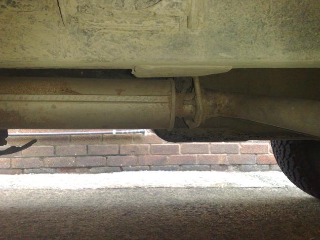

              As promised but still crap at takin pics.

              Not sure its of any help - can take some sat when its on the ramp if you want.

                  Thats great, thanks. Thats kind of what I am thinking of doing, shorten or dump the flexi section and replace with a silencer and tailpipe. I guess that silencer of yours has had the front flange off of the flexi pipe welded on so it seals against the front pipe.

                    Errrm you will have to ask Bushwhacker how he made it - I bought it off him already built and just had it fitted.

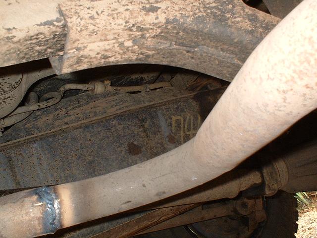

                      here you go,try this one.its not a transit system,but should give you a general idea.

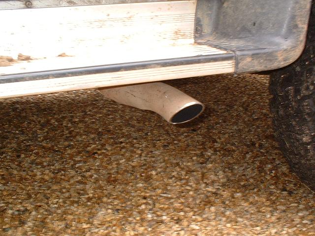

                        Here's my side exit, Cut n shut the flexi n insert an Audi silencer !!!!
