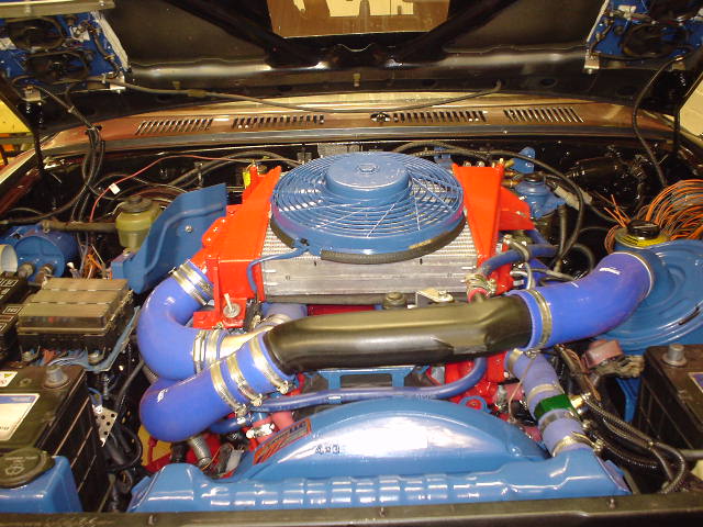

, judging from the photos I’ve seen on the modification forum, the internal diameter of the pipes is 45mm so a bit of pipe work will be required for connections to the surf, I think I’m going with the centre mounting point once I’ve done the 2” body lift but I want to leave access to the oil filler if possible, would i get it in for now without the lift, can't do the body lift untill August
Also how do you best connect the fan, I’m thinking of a thermostat off the turbo pipe or maybe off the intercooler itself, any ideas.

, judging from the photos I’ve seen on the modification forum, the internal diameter of the pipes is 45mm so a bit of pipe work will be required for connections to the surf, I think I’m going with the centre mounting point once I’ve done the 2” body lift but I want to leave access to the oil filler if possible, would i get it in for now without the lift, can't do the body lift untill August Also how do you best connect the fan, I’m thinking of a thermostat off the turbo pipe or maybe off the intercooler itself, any ideas.
to get ya up to the turbo/inlet sizes,(they'll cost ya a bit more than £1.04 tho) as for the fan i run mine through a thermostat switch rated at 40 degree's cut in, 25 reset, you'll need to wire up a five pin relay and a standard relay, if you need the wireing diags let me know, (it aint a real drawing just my interpertation of one
