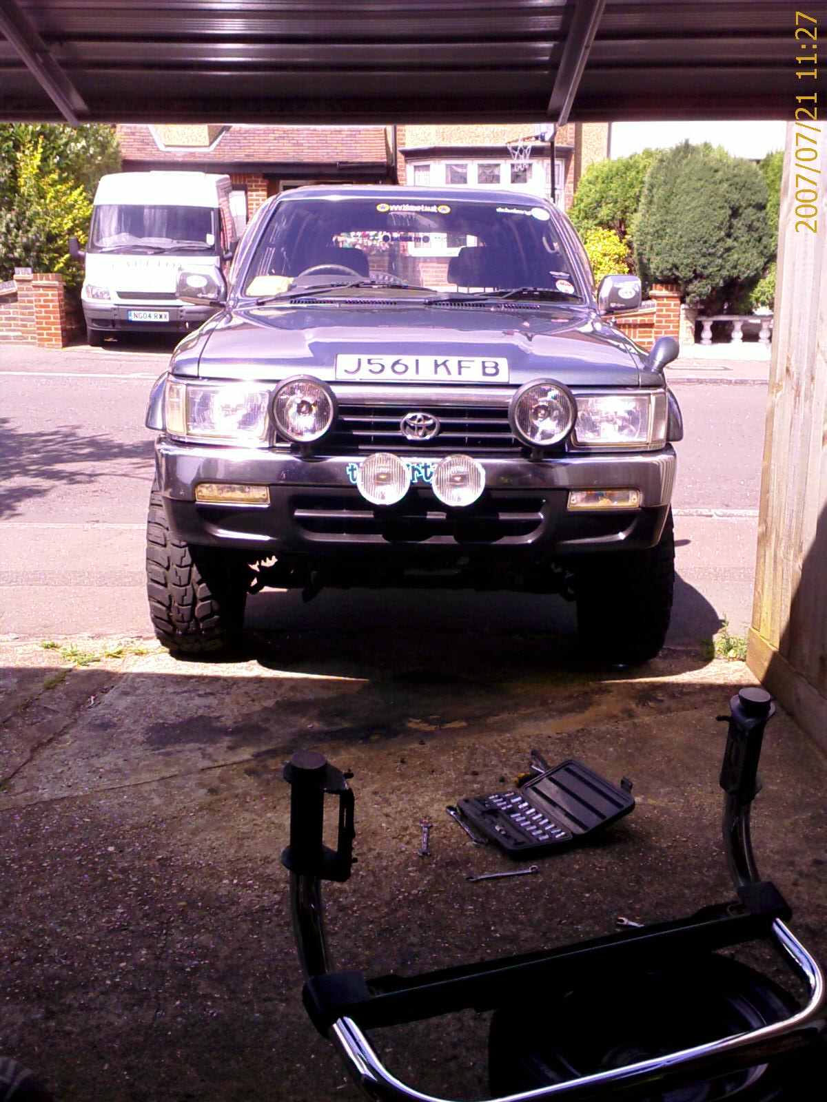

What about it Mark? 1.5" - 2" tube, welded to the front crossmember (under the rad) shaped to follow the line of the bumper and end welded to the side bumper panel just in front of the wheel?

Just sussed why mine looks a bit odd from the side - we cut the arch extension an you have removed yours. Looks better off. Will take it off tomorrow an see if it looks better. Whats it like now?
You can take the indicators out and fit them where the sidelights are, then fit a tranny cooler like this...
lol @ tranny. could you have found a smaller cooler Andy? only joking, mine is too big really and I need to move it again or make a cash plate before Avalanche or its gonna be busted
It's actually shoved up inside the bumper there so it would stay put for the photo. Its twice the height thats visible. 16row, I think.
I have to either cut away a bit more bumper, or drop it down a bit. I'll probably drop it slightly so it gives more space for the hoses on the top.
Mark, will do a sketch today. A pair would be good, but I dunno what I'm gonna do with the other side yet. Maybe I'll just blank it off.
