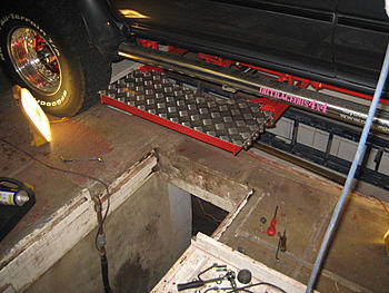

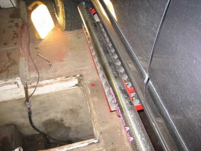

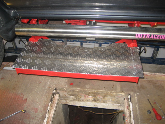

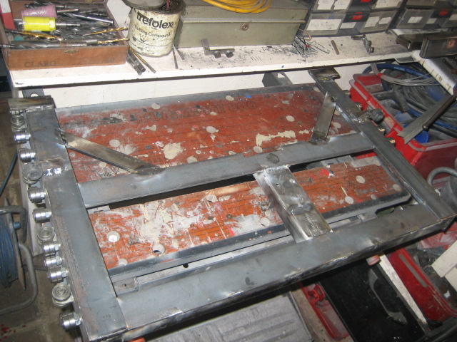

After two days laid low with yet another sickness bug i finally got the dam thing on, it's a bit stiff but i'm hopeing it'll "wear in" it takes my weight so it should be ok  , the bear metal pic's are pre sick and the painted ones are post sick

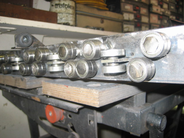

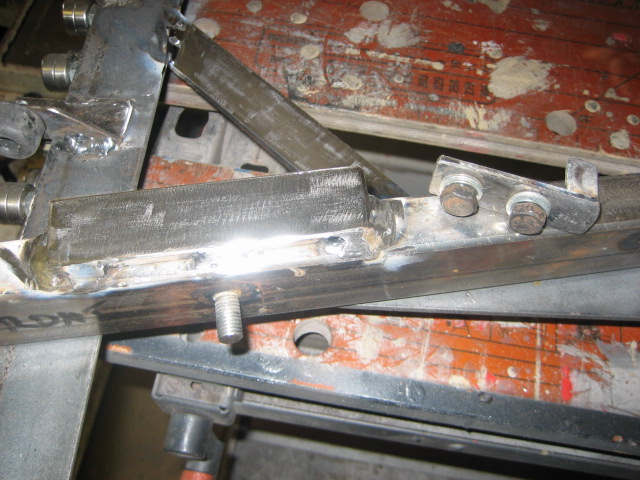

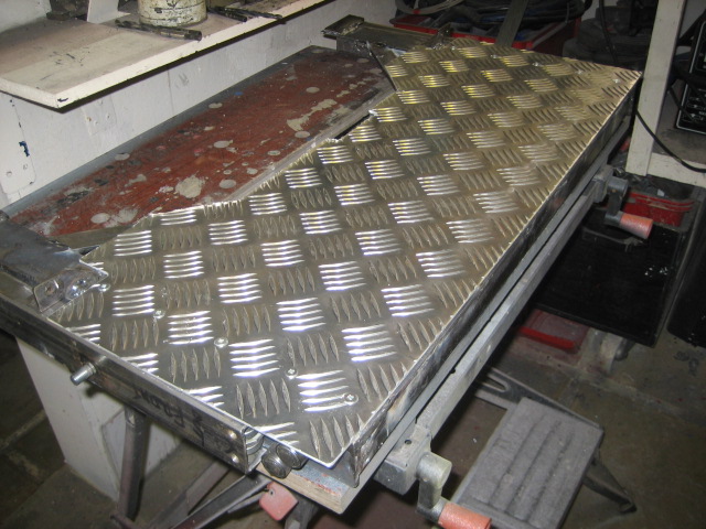

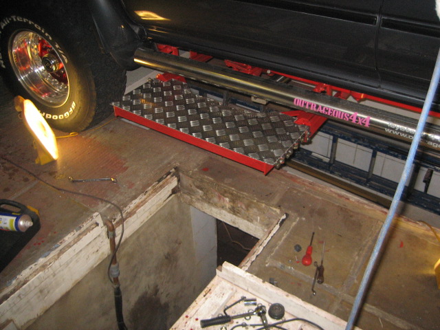

, the bear metal pic's are pre sick and the painted ones are post sick i've got 30 roller skate bearings a side plus the four pairs of horizontal ones (i found in me box) bump stops fitted to stop it comeing right out, and welded some extra slides to help support it, just need a bit of bent chequer plate for the edge (B&Q) and i can dump the beer crate
 i've got 30 roller skate bearings a side plus the four pairs of horizontal ones (i found in me box) bump stops fitted to stop it comeing right out, and welded some extra slides to help support it, just need a bit of bent chequer plate for the edge (B&Q) and i can dump the beer crate on to the air!!!

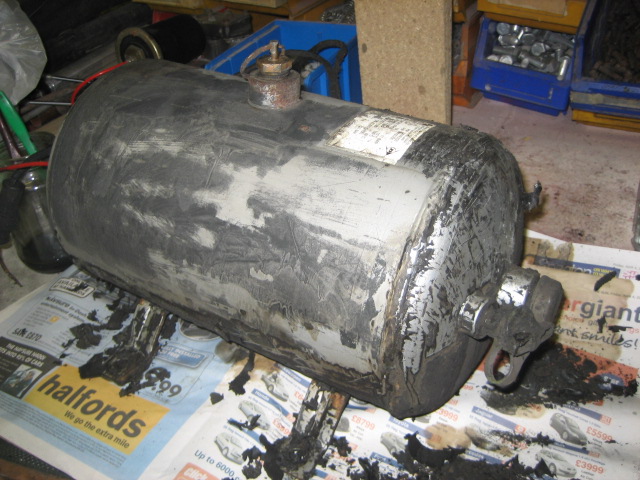

i cant find anywhere to stick the airtank under the truck with out some major exhaust mods (which i cant afford) so do ya think it acceptable to fit it in the back, only down to that i can see is if it blows up!!! if i could get rid of that bl00dy great stock silencer it'd go in there, dont really want it in the cab but i'm sort of stuck, any ideas??
 on to the air!!!i cant find anywhere to stick the airtank under the truck with out some major exhaust mods (which i cant afford) so do ya think it acceptable to fit it in the back, only down to that i can see is if it blows up!!! if i could get rid of that bl00dy great stock silencer it'd go in there, dont really want it in the cab but i'm sort of stuck, any ideas??

								 Looks goodhope you are better, why air would hydrolic not be easier
