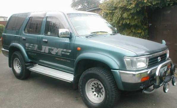

                        It's hard to be certain, but looking at the photo of your surf it seems like the front is already raised on the bars compared to stock - I've attatched a pic of my surf how it was the day I bought it. Look at the distance from the wheel arch to wheel rim. It's smaller than yours.
                        Maybe try winding your bars down and see how that feels. If better have a look at balljoint spacers.
                        Rob.
