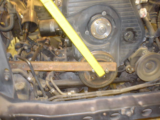

      assumeing the bond has gone you need to remove the fan assbly then undo the four bolts holding the two pullys on the front of the ballencer, slacken off the alt and steering pump (and air con pump if you have one) remove the belts, you need to lock the engine from turning, i had a 2ft bar with holes drilled so you can bolt it to two if the holes in the balencer then when you undo the crankshaft bolt (it's useually tight, so you want a decent socket and wrecking bar for leverage) the bar will jam on the chassi and stop the engine turning, fit the new one (unless your doing the timeing belt) and torque up the crank bolt, not sure what the setting is, i just made dam sure it was was tight, refit everything in reverse order and ya off,

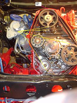

      If your doing the cam belt remove the timeing cover before fitting the new ballencer and turn the engine over till all the timeing marks are ligned up,
      slacken the idler pully and remove the old belt, take care when fitting the new one in case the timeing marks move once your satisfied it's on ok re tension the idler and turn the engine over several times to make sure the marks still lign up, fefit every thing in reverse and should be ok,
