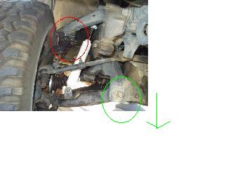

i looked at a truck at the weekend, and the part circled in green had been lowered about 2" or more.
is this the diff drop kit? im just trying to get my head around all this lifting malarkey..
so, to evaluate, the lower arm wasnt pointing upwards from the wheel like in the pic. the joint closer to the diff end, had been lowered about 2". this meant that the lower arm was parallel with the ground.
