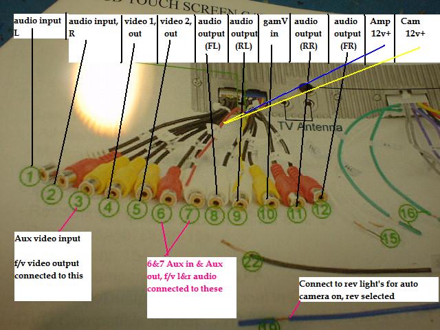

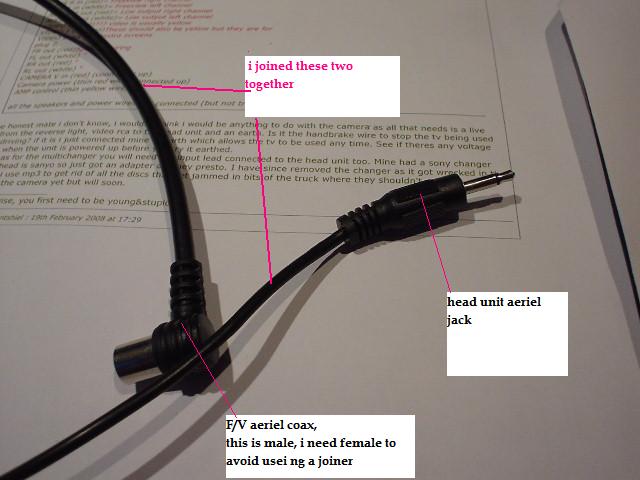

Bit of progress, i have the f/v running channel auto search but it's comeing up no signal, thought it may be due to being in the garage but it's doing the same outside, i've added a couple of pics to show the different aeriel plugs and the rca plugs i've connected to, (think these are ok now) just seems to be aeriel prob,
