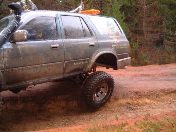

                i had pro comps+3+extensoin brackets and just trashed them
                ended up with psv ajustable shocks on the rear and procomp+3
                on the front
                must admit they may be a little heavy but the rear can now outflex
                a ninty with a 2 inch suspension lift so i am more than happy
                the only prob on full articulation it trys to rip the rear bumper off
                  this is what iy looks like now
