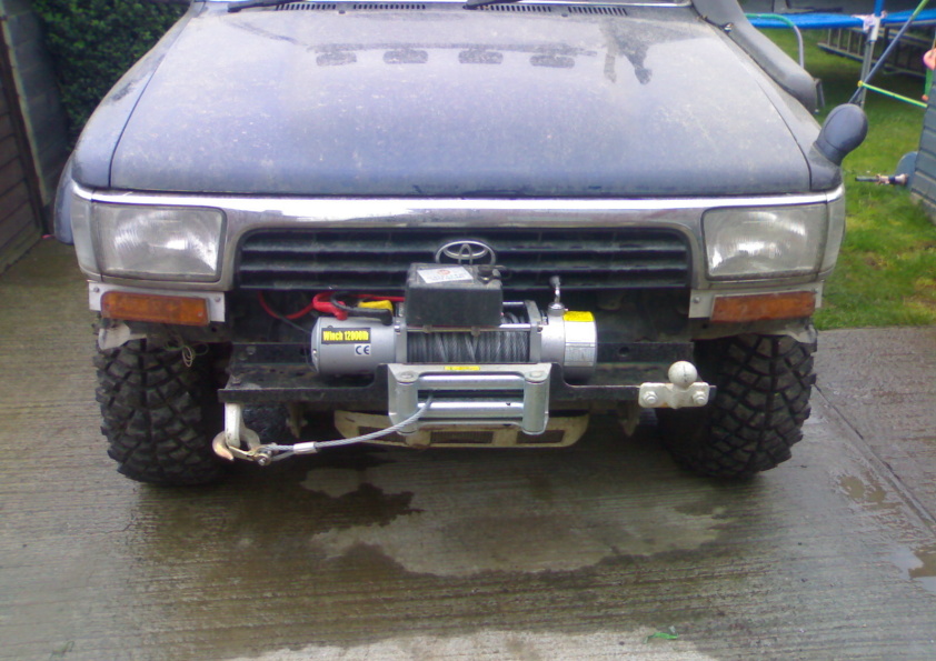

          Ive took off my front bumper to fit mine, i know its not the best looking thing but it works for now. I intend on making my own winch bumper, but thats gonna take time, im only in the idea stage at the moment with a rough sketch being as far as ive gone up to yet.
            Thats lookin good mate. How did you get it mounted so high???

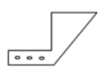

                Well. I'll try explain.
                I was gonna make up 2 brackets to go where original bumper brackets were.
                Make them so they extend to above the body lift blocks then connect them with a bit of box section. So theres rear support if that makes sense!! The bottom chassis rail will have a bit of angle iron bolted to the front. Here box section can be welded onto at an angle to up underneath the winch. Dam i'm $$$$ at explaining..............I'll go do a picture!!
                  Well i had some plate from work, ( hope mi gaffa dont read this)
                  and i cut out two of these...to bolt to the chassis rails then i fixed a back plate to them an a winch plate to the top and welded all togeather...
