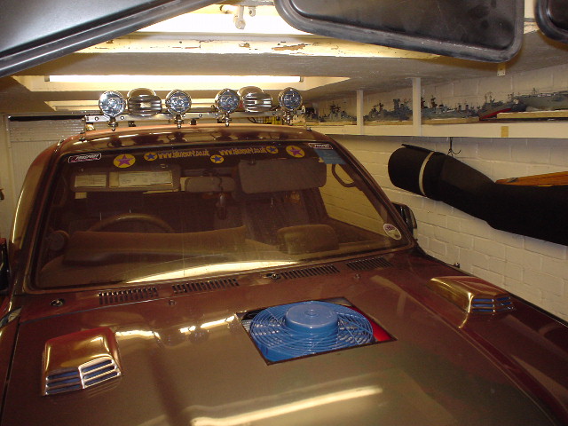

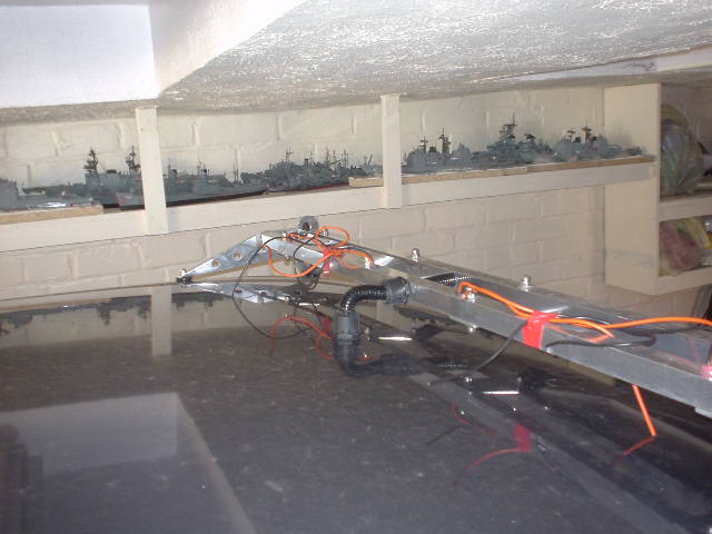

    Personaly i'd fit em to a bar but see what there like when you get em, i would'nt site em to close to the front as you'l probably get glare through the screen, especially if their defused beam fogs, if you fit a bar and want to be able to remove it easily (which i cant) you could use wing nuts to fasten it down and to unplug the wireing (which i cant) get some weather proof connectors from vehicle wireing products, some pics of mine might give you some ideas,
    i used some alloy plate and alloy sq box from b&q

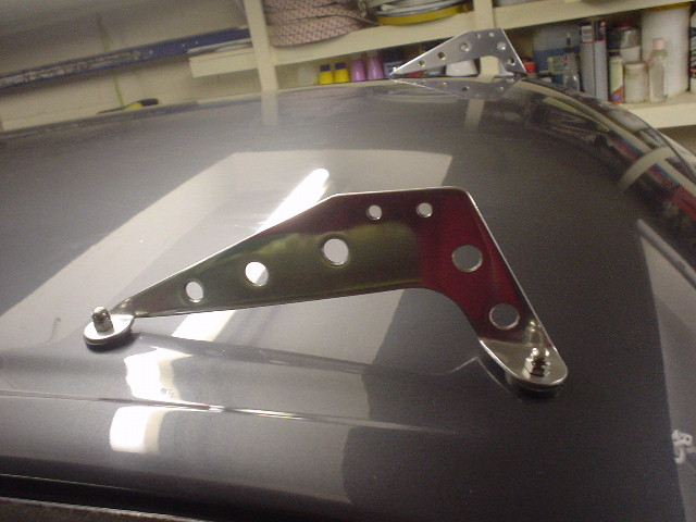

          right these are what they look like taped in position(ish) for fixing directly to the roof. This section of roof is double skinned so all i could do in terms of fixings is get everything marked up and in place then use self drilling screws. But i think they look OK and i'm tempted to go this route anyway, i'm no fabrication genius and any brackets i make at home for a bar isn't going to look any better. I guess the telling thing will be how much glare/reflection there is on the screen.
          I have 4 lights, but only taped 2 up to get an idea of what they're gonna look like.

              They do look quite good there, but being fogs you probably will get quite a bit of glare on the screen. You could either mount them back an inch or so, or put in some form of dark sun visor strip. Wait until tonight, and then jerry-rig them up so they come on (couple of wires and a fuse!) then you'll be able to tell if there are any problems.
              My only other comment is that two look a little lost, get two more if possible.

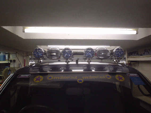

                          Got the 4 lights all fitted up today and went for a drive tonight, the fecker's are glaring on the screen like mad. Typical, they were fine when i trial fitted them yesterday and jerry'd them up, guess it must just be coz it was on the driveway and too much other light around being in town. Sure i can sort it though, might try fibreglassing up a sun visor type thing tomorrow or just bending some sheet metal round the lower edge of each light.
