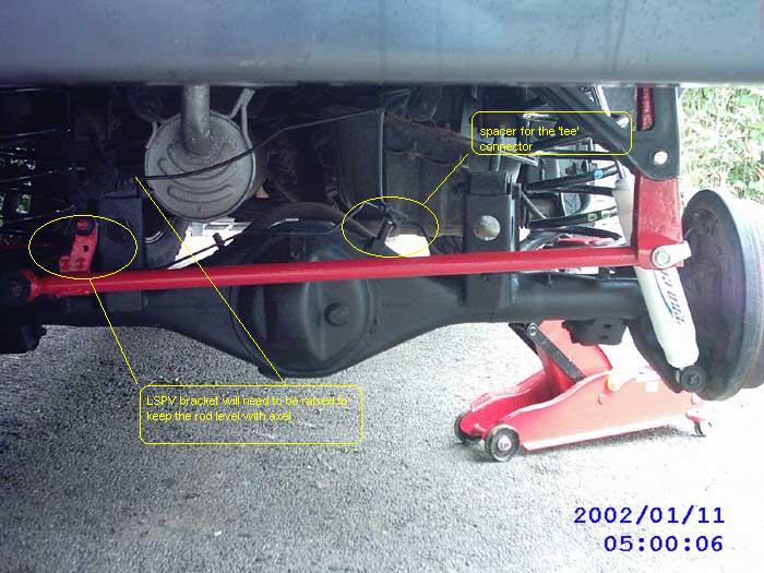

          Now you'll have to either fit a longer flexy brake hose, or make up some sort of spacer like I did to keep the slack in the original brake line.
          Next is to fabricate a bracket to raise the LSPV. I just removed the bracket and turned it around and re-fitted it so that the LSPV was two inches higher.

                      Yeah, well I had to do all the other c rap 'cos I would have ripped my flexy brake hose off, and my rear wheels would have locked up before the fronts and my wheels stuck out about an inch on the drivers side. so..........
                        Here's a picture of my under carriage (snigger!!)
                        All these mods are home jobs.
                        Everyone thinks I'm paranoid!!
