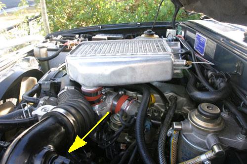

                    The light should come on at around 1800 rpm, and you should be able to hear the turbo whistle.
                    you will be able to tell if it's not working, verrrrrrrrrrrrrrrrrrrrry sloooooooooooooooooooow truck!
                    • #25
                      That the same as being sluggish?( I was of the opinion that the truck was lazy)
                      Where does the signal for the light come from?
                      • #26
                        Yes it will be very slugish!
                        This is the air temp. sensor.
                        • #27
                          more info here..................
                          http://www.toyotasurf.asn.au/techsite/turboboostfix.htm
                          • #28
                            I find the light very annoying, as it is basically always on during normal driving.
                            You will not feel a "kick" as in a turbo powered petrol engined car, as he turbo it an LPT, low pressure turbo. Its just to help rather than make massive performance gains.
                            I would imagine that the light is just a very primative boost gauge, than senses when the turbo boost reaches a certain level and just comes on, to let you know its working.
                            though as has been stted here, if it wasnt working, you'd know about it anyway as you'd not hear the whistle, and surf you'd be even slower!!
                            • #29
                              Turbo Sorted
                              Thanks a MIL Bushwhacker and all who gave info.
                              The Diagnosis was that my vacuum line to turbo sensor got knocked of while I was tinkering and Temp sensor was not plugged back in
                              Dev
