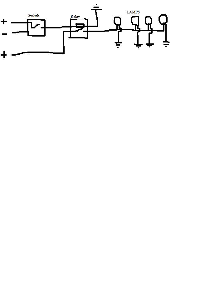

        wiring diagram may help a little.
          the relay should have a little diagram on it too... showing which pin is switch, supply, load, gnd etc. etc.

                I think that must be the problem...... originals must have been dippers, its what is called a three pole switch.
                Loved the alcohol induced drawing by Matt, thanks for that one.
                I put a meter across the switch, and I get a voltage drop when the switch is operated.
                So now I have assertained whats what .... a rewire is the order of the day.... damn.... nothing is ever simple with Toymotas is it !

                      haing a touch pad, not a mouse doesn't help... but the hands are shaking!!
