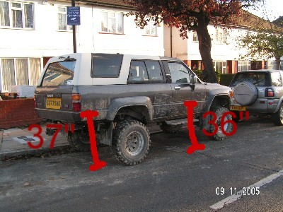

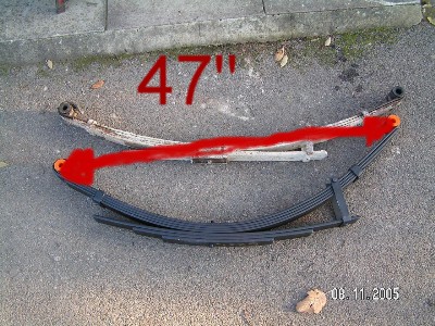

Rick, investigating a clonk noise, found a problem, I think my rear springs are a little long, the shackles are laying flat against the chassis. What do yours look like?
I think I need to move the rear mounts back a little, to get some spring movement back, I've got extented shackes on the pickup axles, will try them first, being longer they might pull down and sit better.
Odd though, the springs are supposed to be for a MK2 Pickup, which has the same chassis as mine as far as I know.
