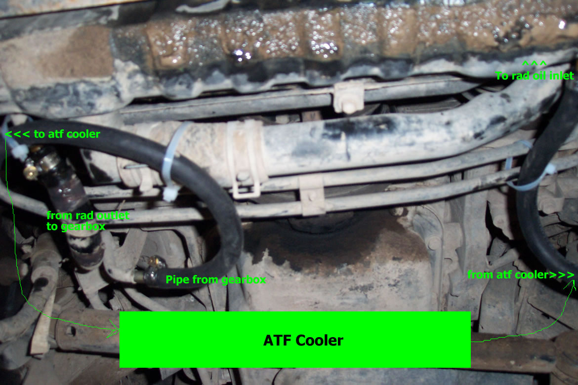

hope this one helps...
NB: you do not need to cut the rad outlet to gearbox pipe at all, I had to to investigate and cos it was
stuck on
leave it be and add in the other pipes
