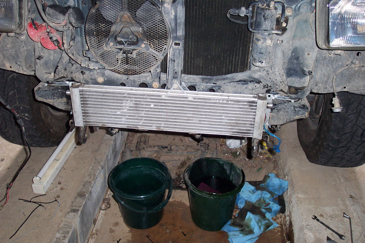

    i'm doing the new transmission cooler trick (right now! oily hands and everything!) which pipe on the std cooler in the rad is feed and which is return? i know, start it, and the feed is the one blowing oil, but i dont want to make that much mess... help!

              in that case the pipe on your right as you look at it is the feed to the rad and it makes quite a mess when your not holding the pipe as I found out

                NO! stop! panic! as you look at the engine bay its the pipe on the right into the bottom of the rad... phew

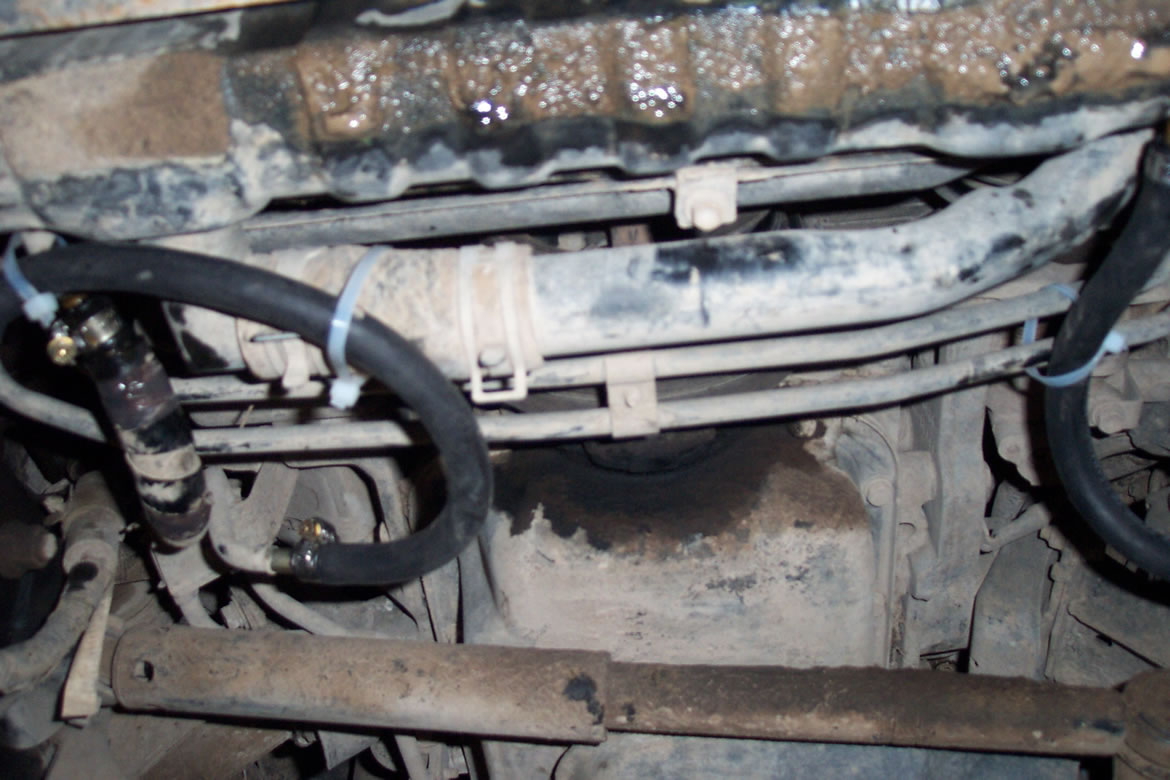

                  So that is, standing in front of the 'toy' looking at the front...
                  Passenger side that has a nice bend in it... (right hand side) output of the gearbox. Right hand hose in your 2nd photo dirtydog...
                  Driver side that has a shallow bend in it... (left hand side) input to the gearbox.
                  Just to clarify... "Passenger side" into new cooler...
                  Out of new cooler into rad cooler...
                  Out of rad cooler into "Driver side"...

                        well i think its done....

                              Originally posted by dirtydog
                              errrm yeah something like that - the input on the bottom right of the rad is the feed, follow that pipe back - ill post a diagram later.
                              heres this for the time being - ill edit a real photo now to keep some of you going, look out for the write up soon!
