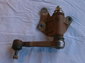

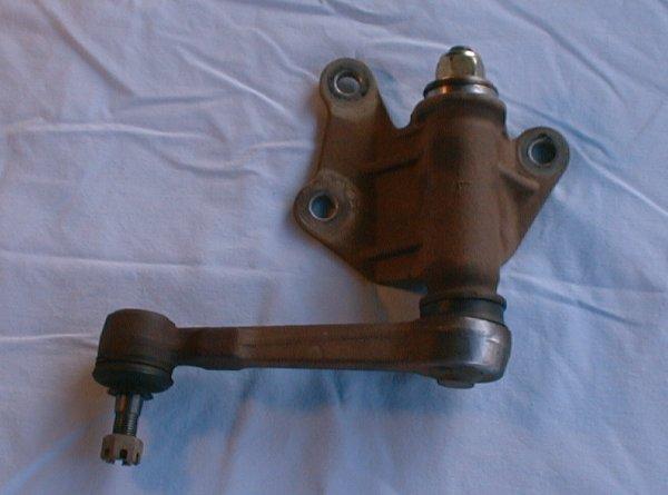

    My Surf pulls to the left also. To cure it (when I have money), I'll be replacing the pitman arm and the idler arm bushes, as a couple of guys on here are doing quite soon...
    http://www.yotasurf.com/forums/showthread.php?t=11418
    Hope this helps...
