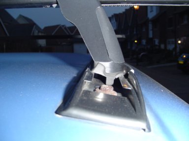

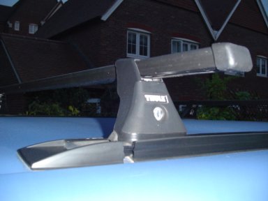

            I got over this problem by going to Halfords and looking at their different Thule kits. I did'nt want a system that went under the lip of the roof and then clamped on.
            Instead I bought kit for another vehicle (sorry I cant remember) and found that the plate which slides in the track and attaches to the uprights was too narrow by about 5mm. ( the plate needs to be as wide as the inner width of the track). New plates were made,holes were drilled in them and hey presto, they look great and they are as solid as a rock!
            I will try to attach some photos ( sorry, took them when it was quite dark ).
            Is this what you are after?
            Cheryl
            xx
              Cheryl
              xx
              I need ladders on the roof on an almost perminant basis, and found the same as you, the kit works fine for the bars and the upper fitments.
              To lock the end pieces into the roof rails I went to a local stockist of 'UNISTRUT' (found via a search on line) and bought - 8, 4mm tapped channel nuts for the 2000 series track and they fit the roof rails perfectly and only cost aprox 20p each.
