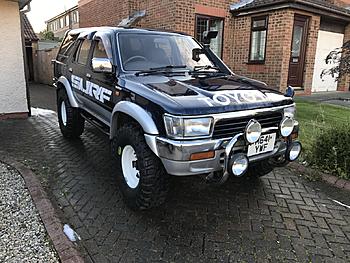

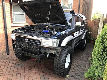

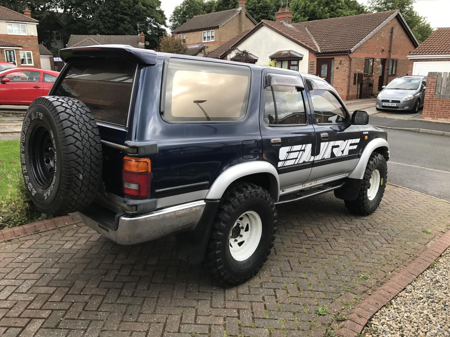

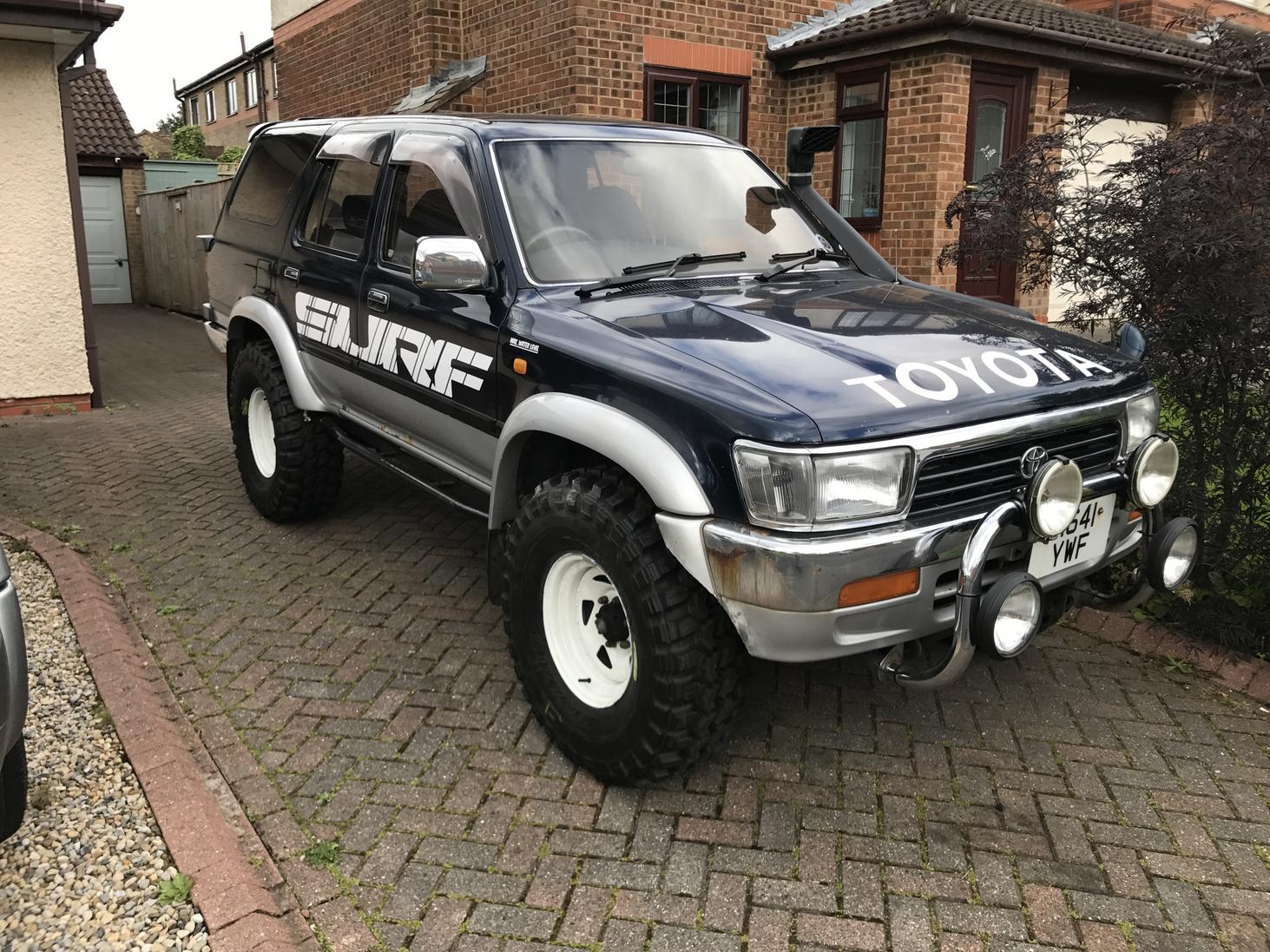

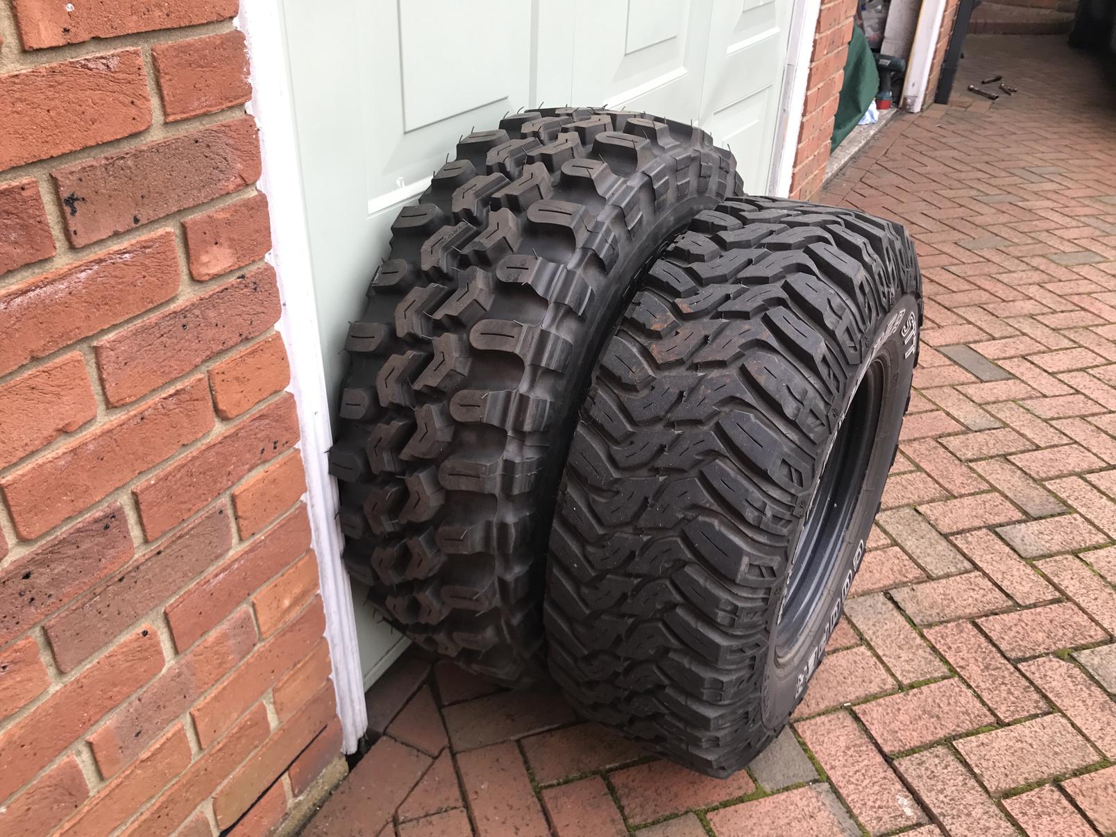

Just thought I would upload a couple of pictures of my Gen 2 after I fitted 33".
The tyres are 33" Nortenha 33x12,5x15.

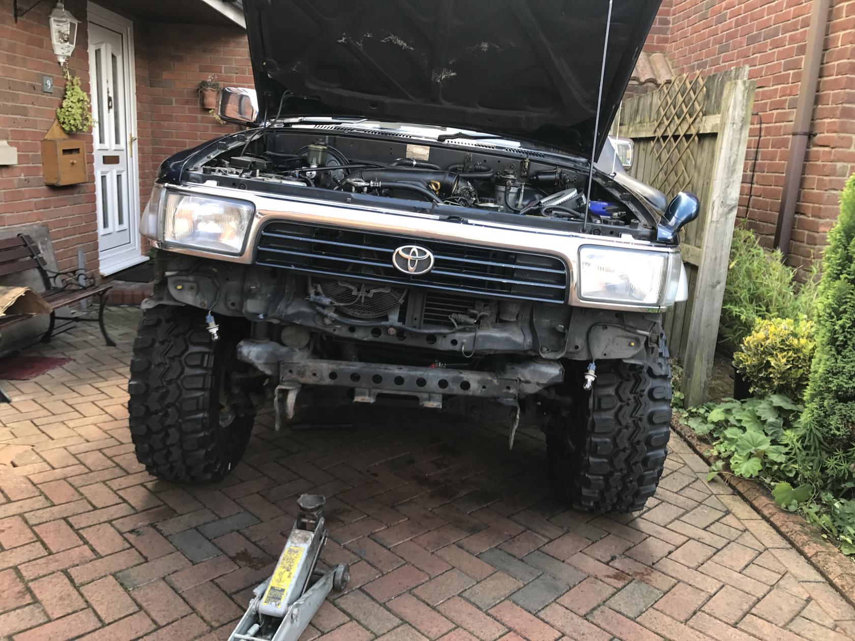

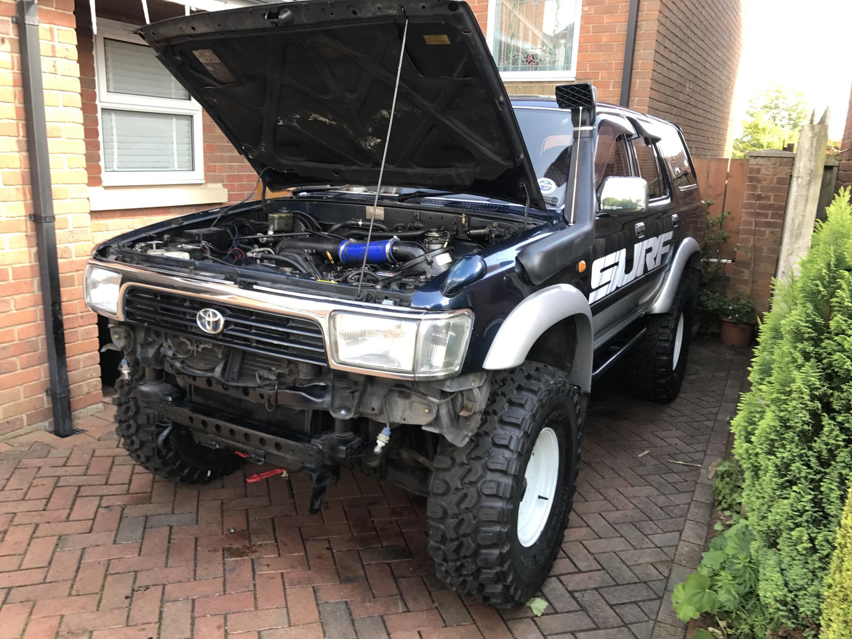

They fit perfectly with the 2" suspension lift, apart from a little mod to the front bumper. I intend on doing a 2" body lift next weekend to do the job properly.
The arches all need some small extensions to stop the tyres from protruding, currently they stick out about 10mm, but the extension will finish the front arch/bumper where I have trimmed it.
