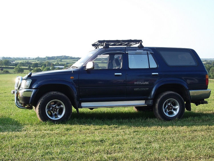

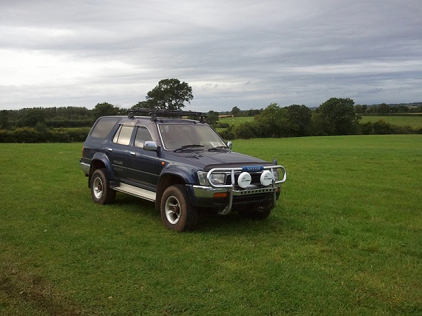

Much better now than when i first bought her.
Stuff done so far include:
>Bigger bull bar and big spots fitted.
>Usual service and fan belts replaced, just got to do the cam belt.
>Hid headlamp bulbs awesome at night.
>New front bumper as the old one was rusty and horrible.
>Bonnet guard.
>After overheating last year, i replaced the thermostat and all the coolant hoses as they start to bulge, and filled with red coolant. Since that i have never had it overheat, even towing over 300 miles on holiday.
>New inner and outer track rod arms and adjusters on bothsides, and tracked properly.
>New inner and outer cv boots on front off side driveshaft.
>Front anti roll bar bushes uprated with polyurathene.
>Full chassis and underbody wax oiled, hopefully no rust issues to come now.
>Rear anti roll bar bushes uprated with polyurathene, along with new drop links.
>New uprated and lifted by 2" rear springs from rough trax.
>All three rear bumper sections replaced with nice shiney new chrome ones.
>Rear step fitted behind the tow ball.
>Inside i have fitter a boost guage and a momo millenium sports steering wheel.
>Roof bars and basket are just for the holiday, although it does look quite good
Ive spent a lot of money on her recently, however if you like your car that much then you will wont you.
I plan to lift the front end by 2 inches at some point too, probably do the ball joint spacers and drop the diff down with the anti roll bar drop brackets too. Or just wind the front torsion bars up a bit. Next a stainless exhaust and give it a nice little burble, nothing too loud. Finally some new tyres currently have Falken Land Air AT 265/70/15 on the front and Falken Land Air T110 on the rear. Looking at getting some General Grabber AT 31x10.5/15.
Think thats about it
Thanks for looking.
