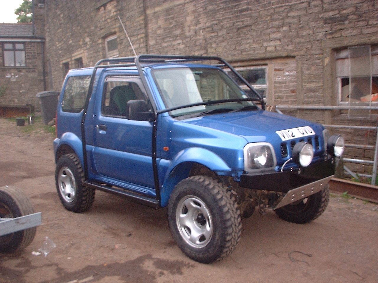

    The only thing I need to know now is what guage steel is recommended for the roll cage. I'm going to go for an external roll cage so the uprights and horizontals will be in excess of 4Ft.
    The front bumper and rear skid bar are going to be 2"x2"x1/4" steel box section.

                  Just got a quote for mild steel tube. 2x 7.5Mtrs 33.7mm O/D x 4mm wall - £72.73 inc VAT but they want £16.00 + VAT to deliver. I live half a mile from their yard!!!! They cant cut it so I can collect and I cant go there to cut it (health and safety blah blah blah).

                        I'm still using 1.5" x 4mm tube for the roll cage.
