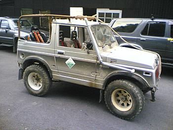

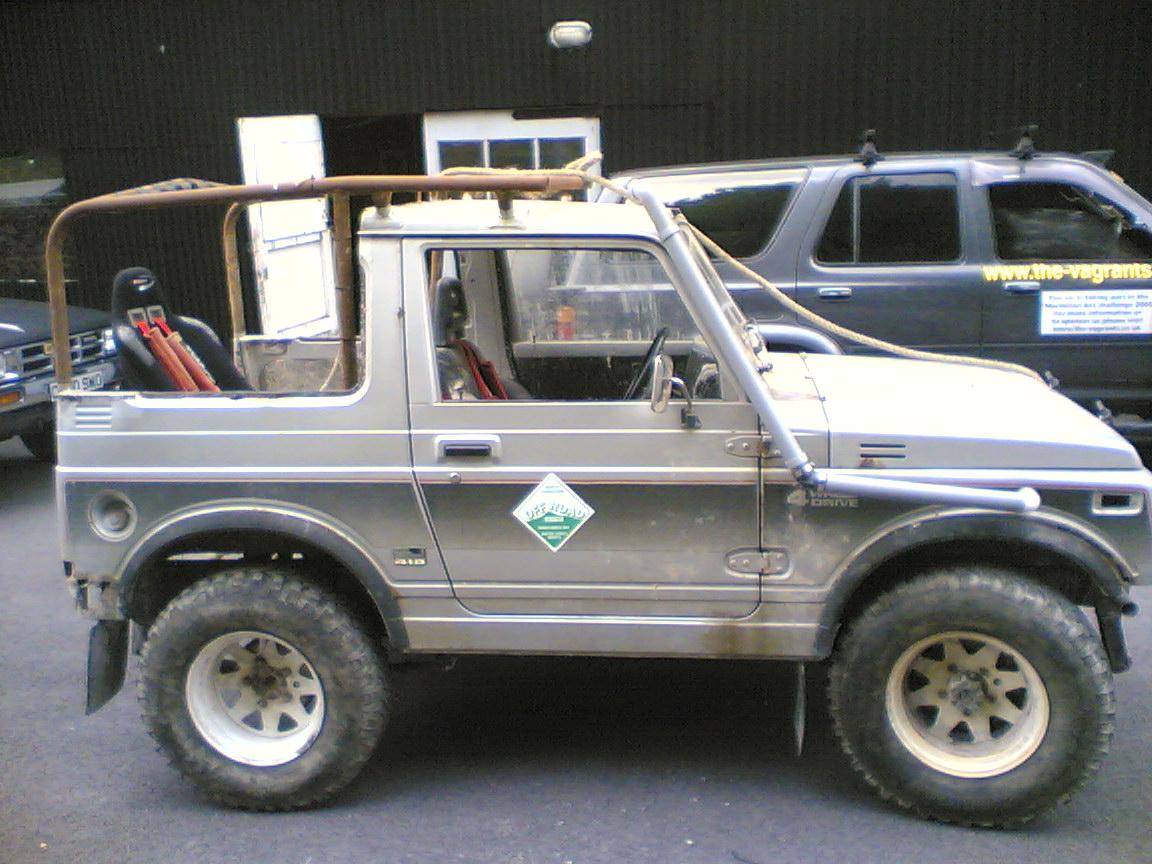

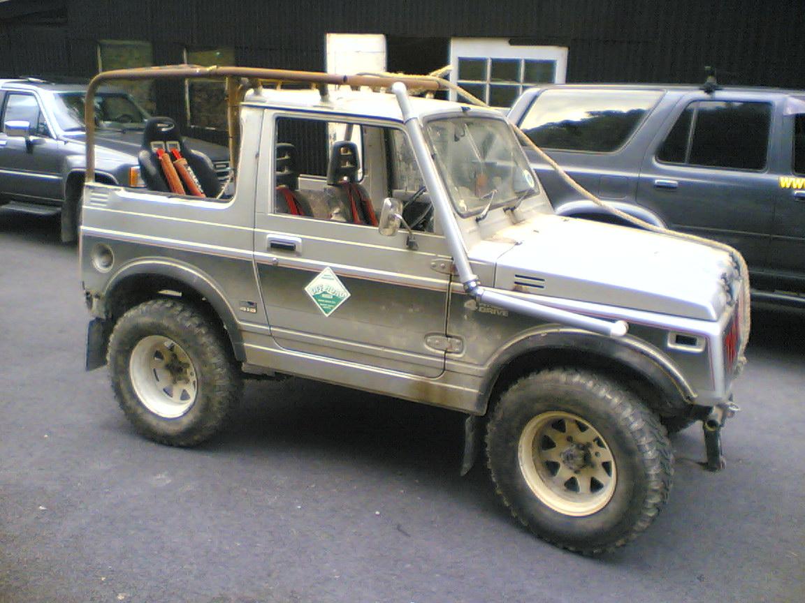

    The vagrant is alive, after all Ricks hard work the suzi is up and running again.
    I'm a custard donut monster
    Good job! This weekend inspired you Rick?
      Done most of the work over the last 4 weeks . New clutch , new tyres off a bloke at The Pit , fixed broken wiper linkage and replaced 1 wiper blade clip , Jon and Adam built a new heavy duty Suicide Seat base . Rear brake disc kit not yet fitted , all parts there just need to get round to doing it .
      Today we just put the wheels back on and gave it a run up the yard .
        Looks like it's almost ready for some mud - or at least some thick dust
        Roger
