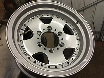

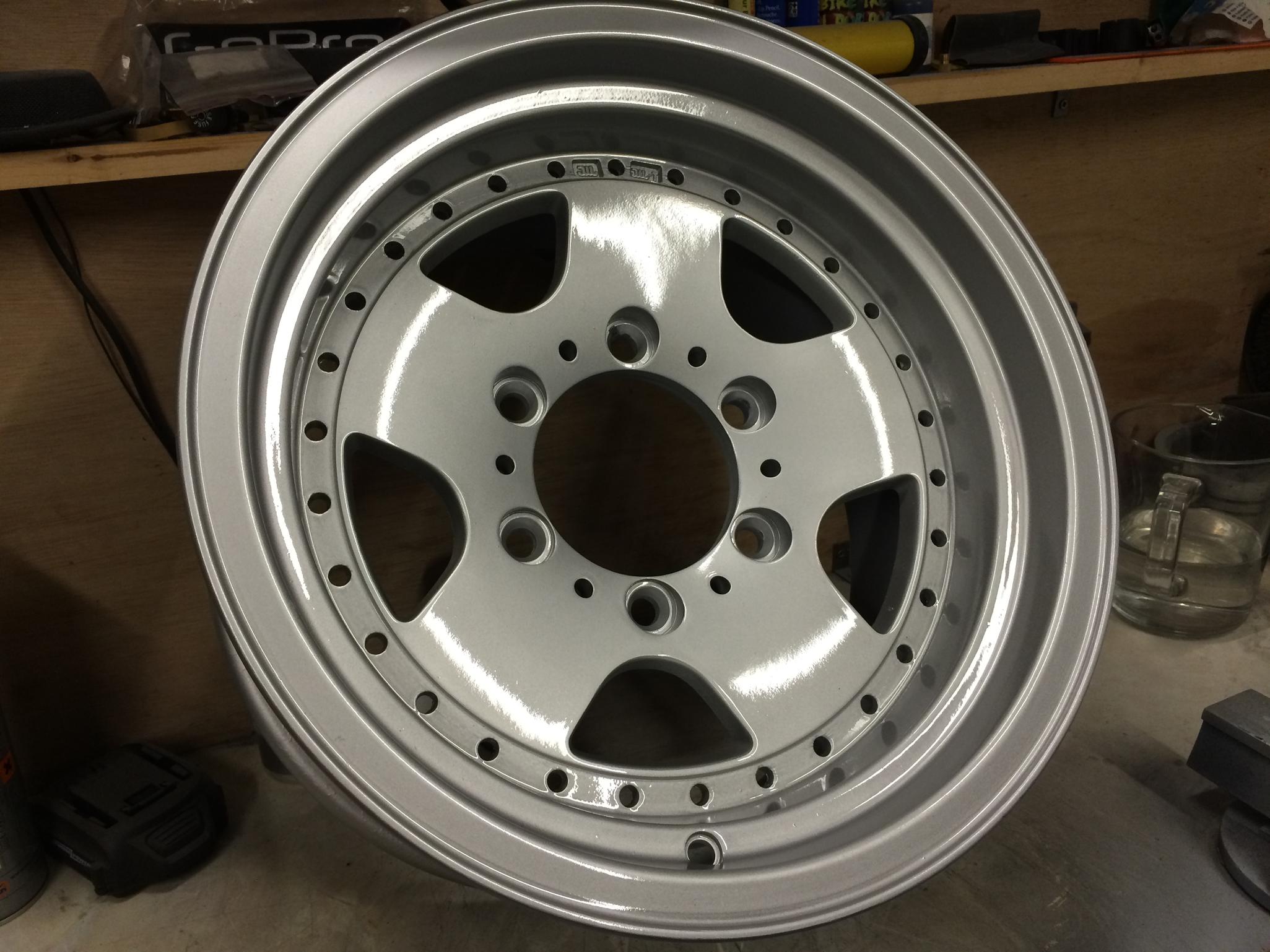

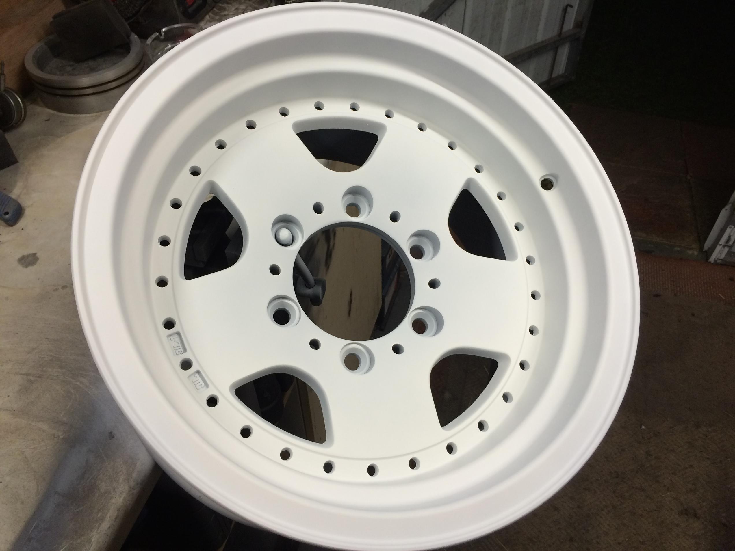

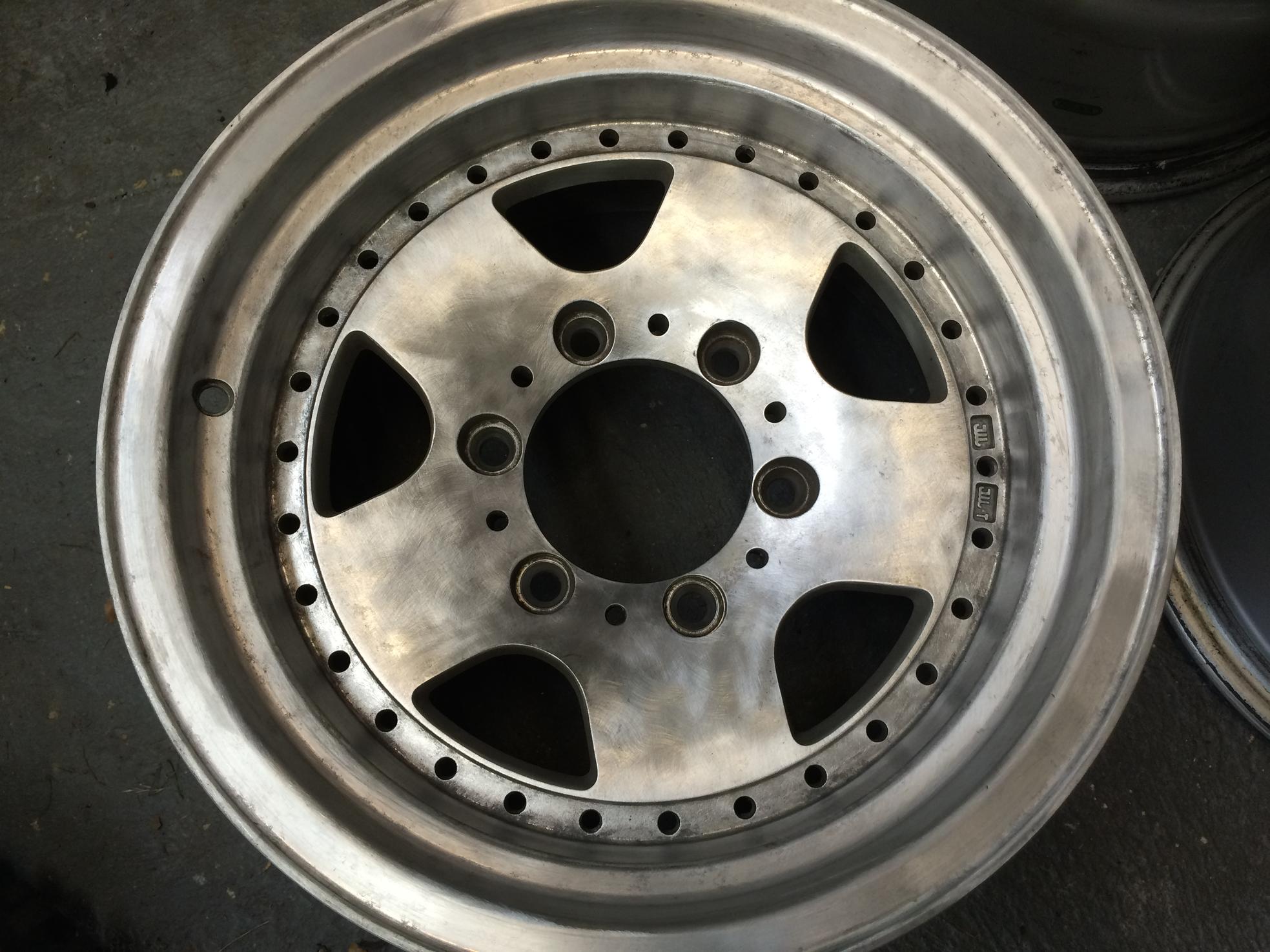

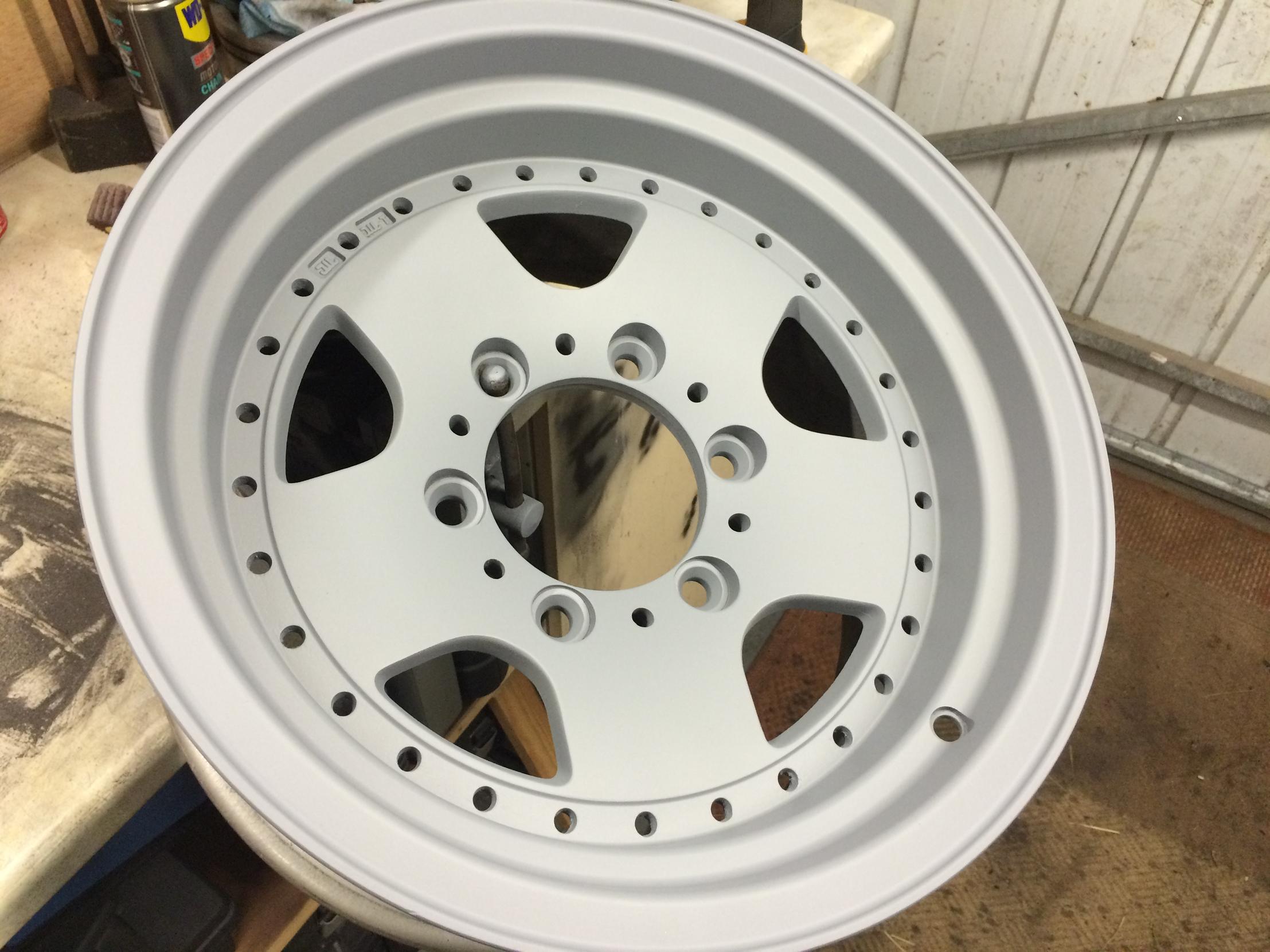

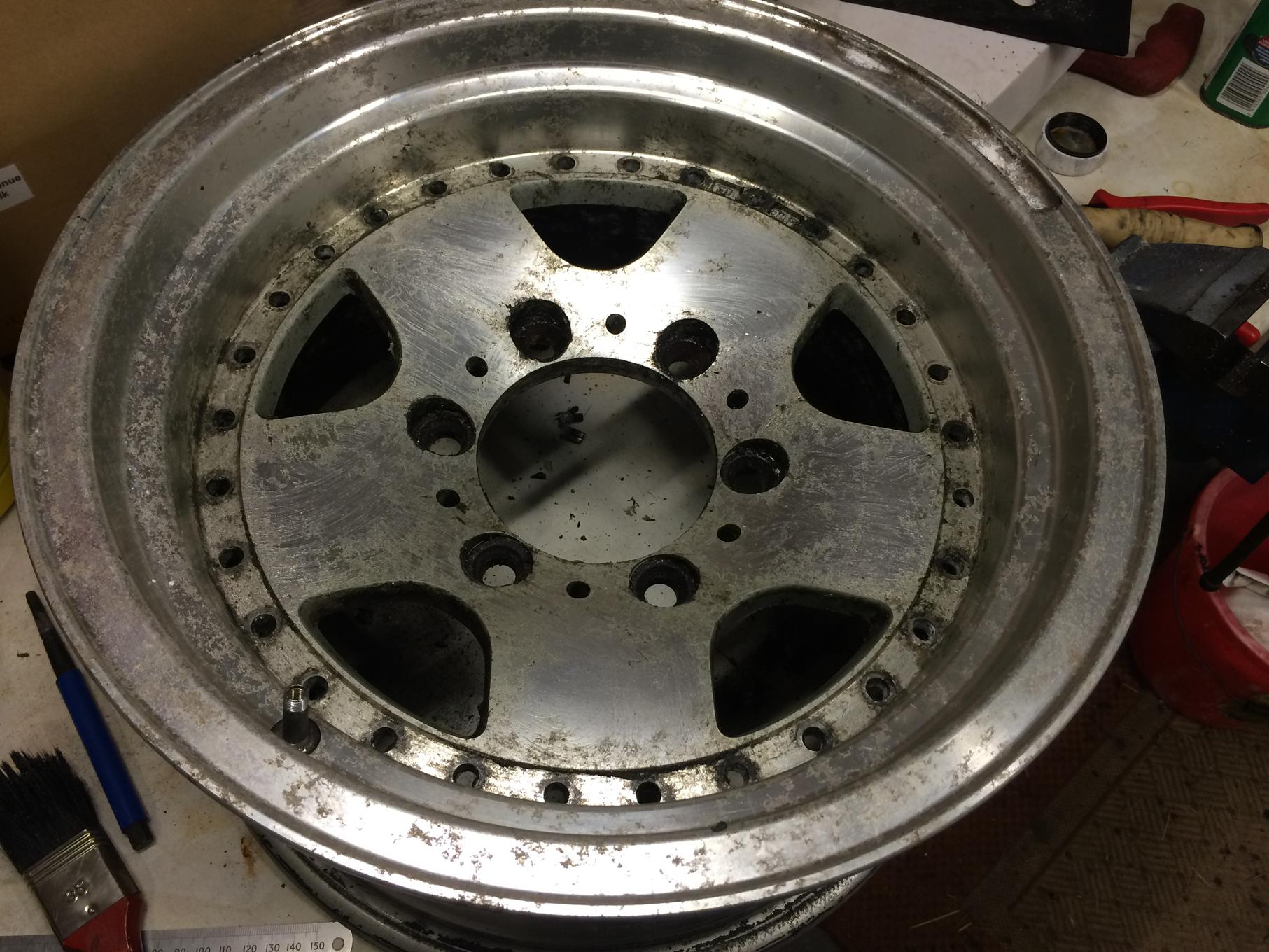

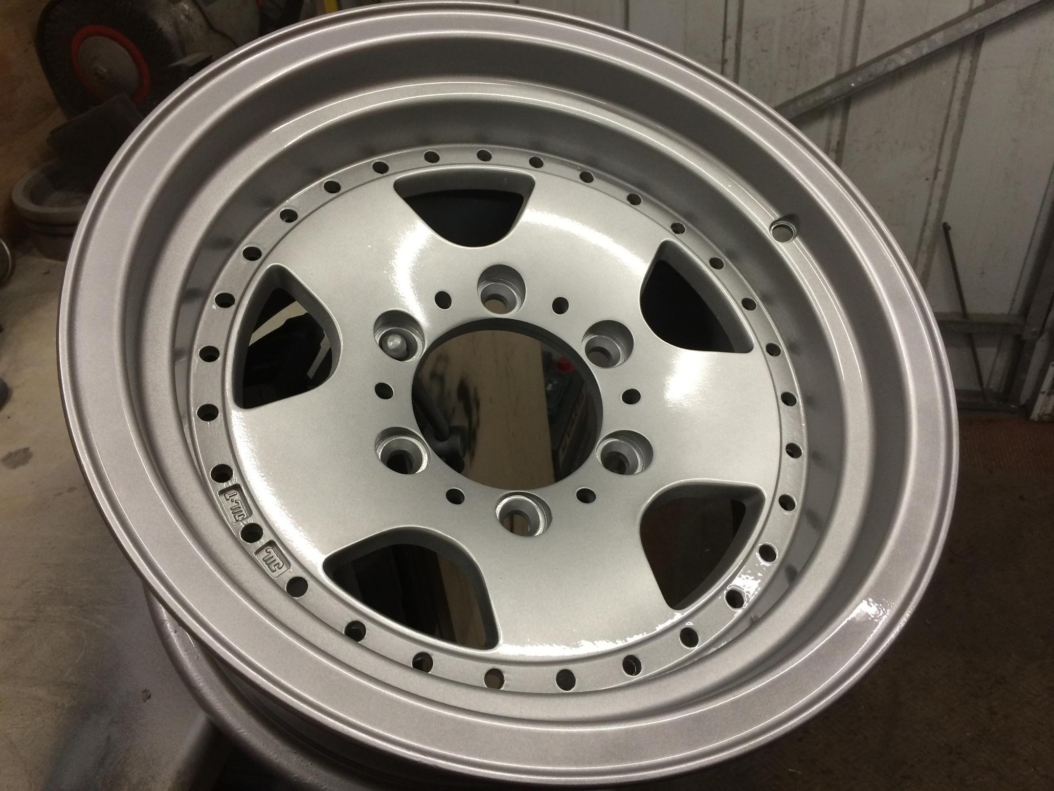

    So been sorting out the wheels i bought , which had a lot of lacquer peel and corrosion on them , finished the first one off today with vauxhall star silver 3
    Took ages to get all the old lacquer off and a lot of rubbing down to get a good base to paint onto but i think its come up good so far after 3 coats of primer , 2 top coats and then lacquer just 4 more left to do lol !!

    Cracking job
      Looking good, top job.

        scrubbing
        I found those purple 3M abrasive sanding mesh things worked wonders at removing the lacquer and not destroying the finish of the wheel.
          you got so close,,,,,,,,,,,,,,,,,,,,,,sho uld have polished them
            Scotch brite fine multi flex is the stuff I used.
              scothbrite pads rule. thats looking like a nice clean job there.
