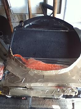

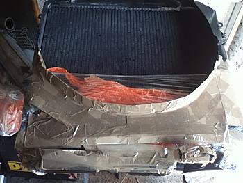

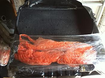

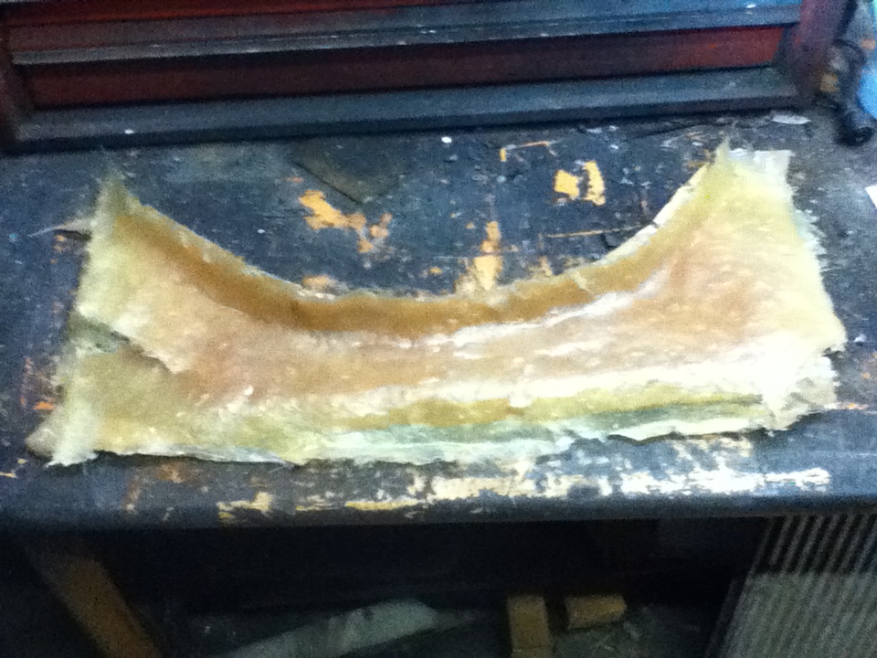

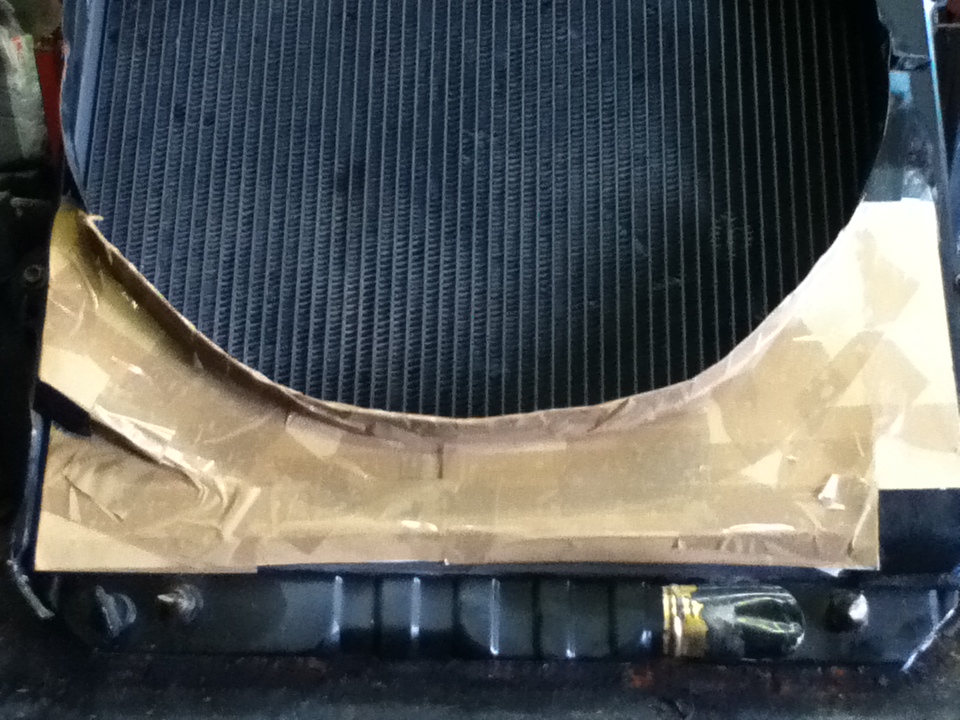

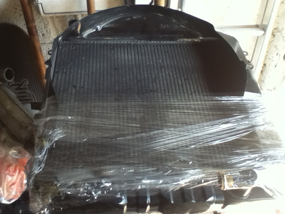

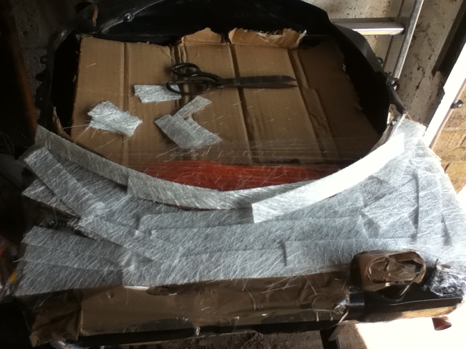

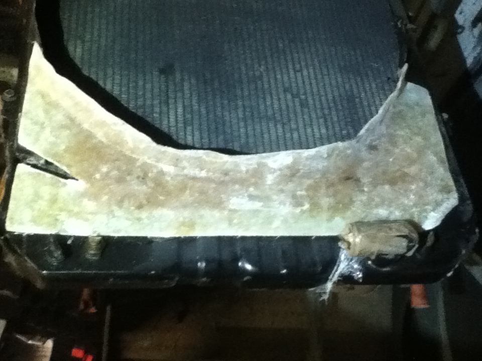

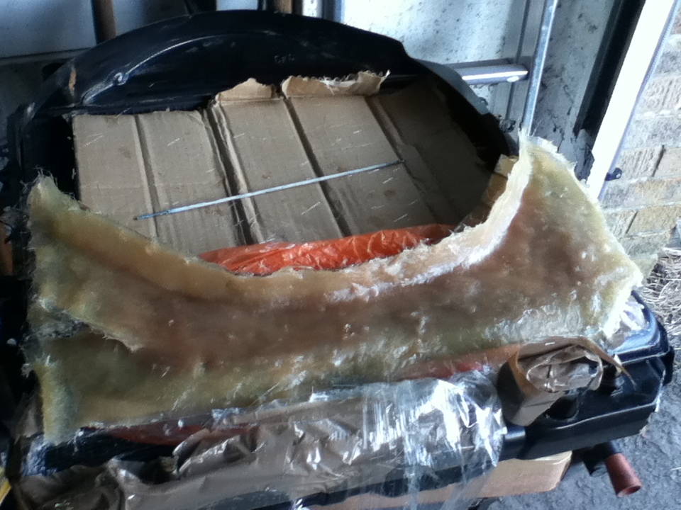

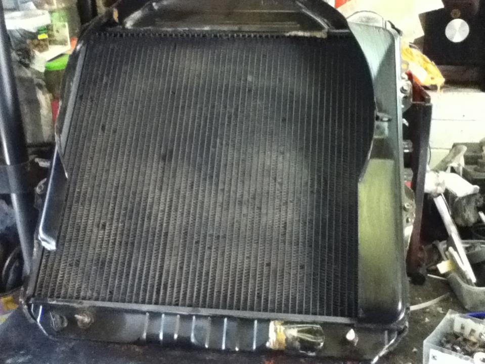

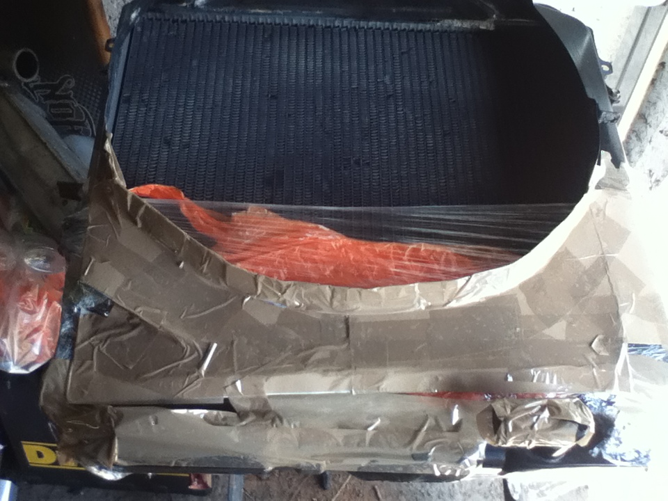

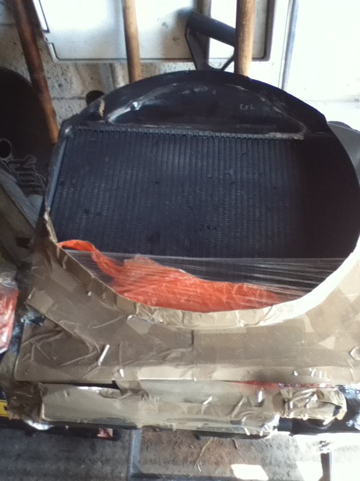

Having lost the radiator lower fan shroud years ago and with the drive to improve cooling, I decided to have a go myself.
Quite frankly I can see why the OEM lower shroud gets ditched.
After a few cups of tea and some head scratching he is what I did.
I will let the pictures explain.
Quite happy with the results, it ain't gonna win any beauty contests but after a final trim and rubdown it fits exactly the profile of the rad, just needs a rub down and a quick coat of matte black.
I have some SS hex head self tappers to hold it in place and with a some foam tape to make a good seal it is good to go.
Now the rad can go back in and I can finish off the other cooling system mods.
