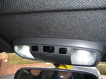

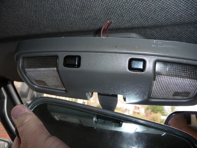

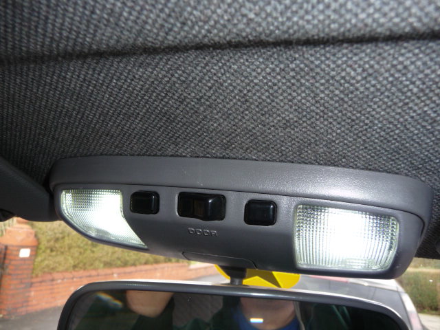

If you compare Surfs, you may notice that on some, the map reading lights with the rear view mirror attatched, have an additional rocker switch that enables these lights, also to come on when a door is opened. the existing wiring to the connector block is already there. It's just swap, plug, and play. I put two 31mm 12 LED bulbs in to match the rest of the interior, so the overall effect is now retina searingly bright.

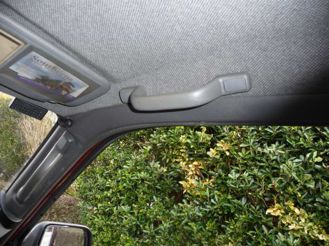

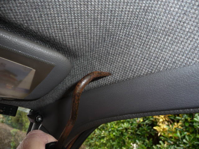

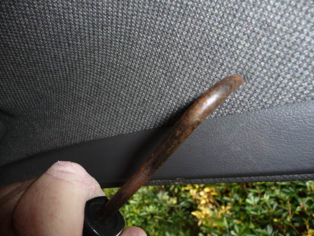

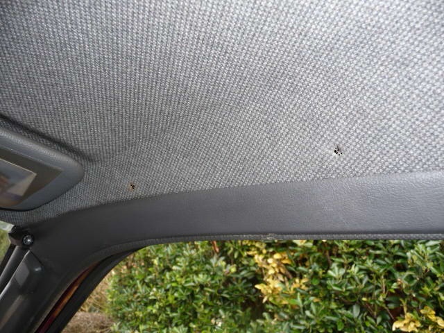

Also, Did anyone realise that on the drivers side, under the headlining, there are two captive threads that will accept an additional grab handle? (Use a spare passenger side one). Presumably it's there for the LHD 4Runners.
