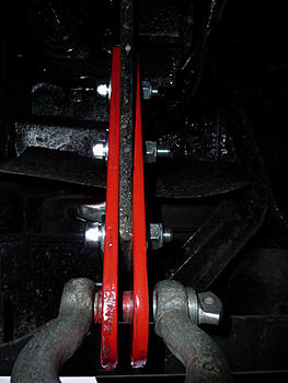

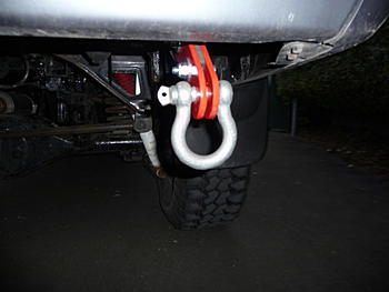

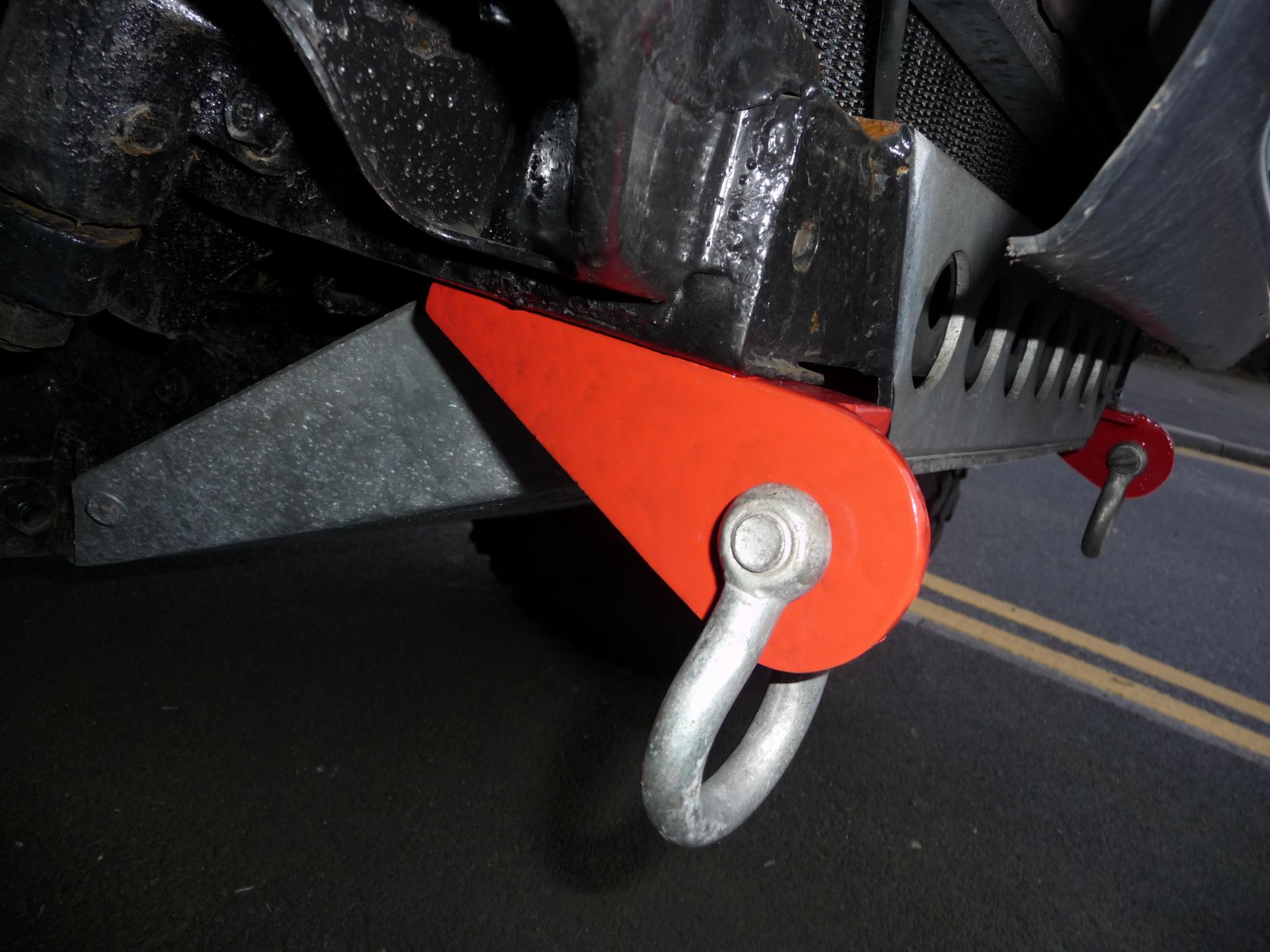

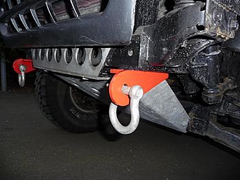

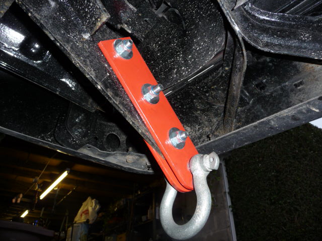

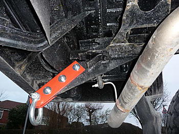

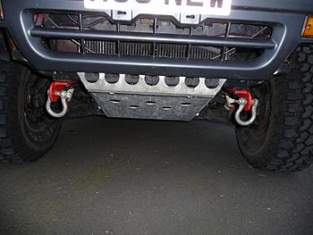

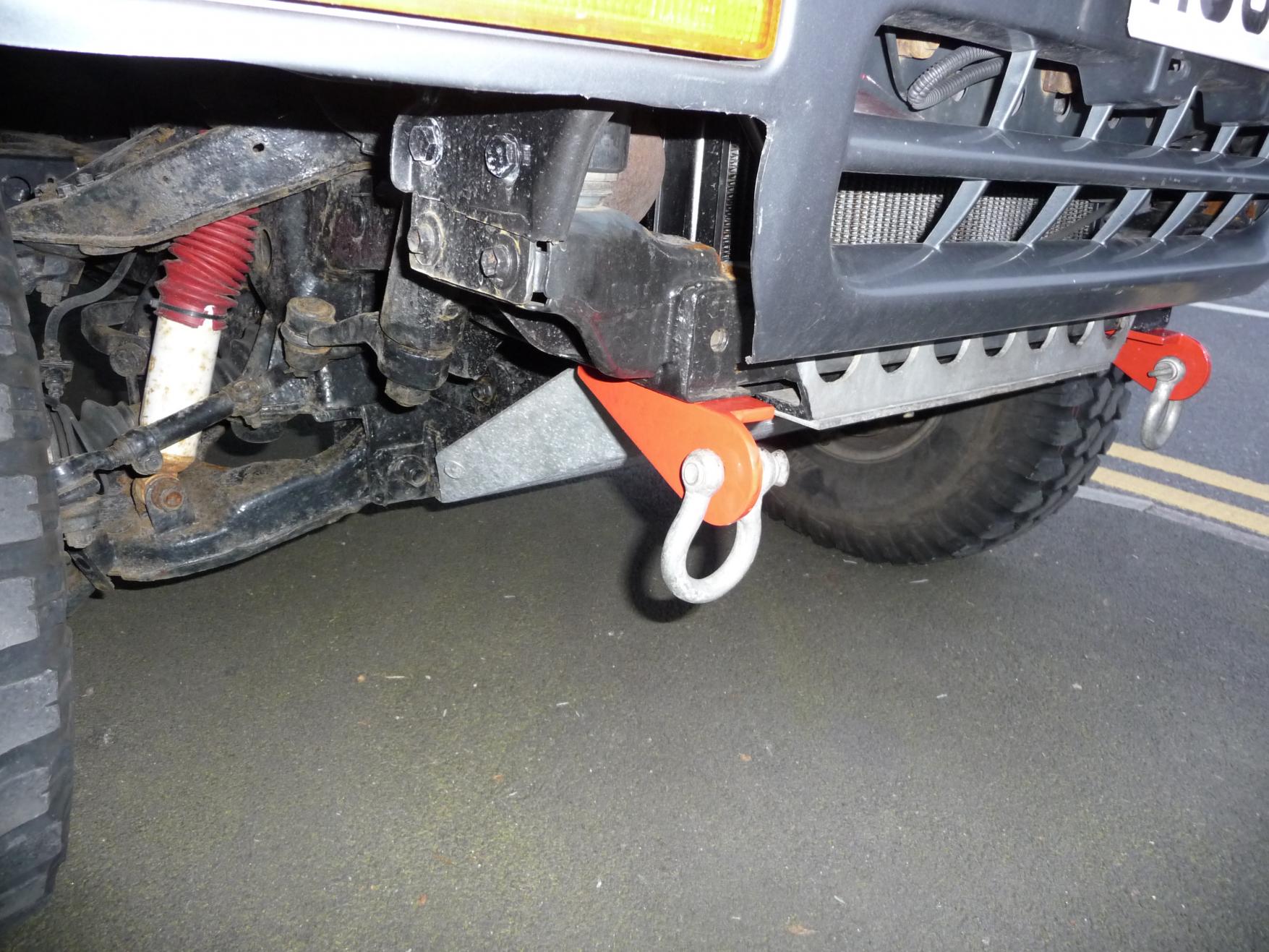

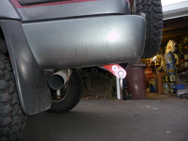

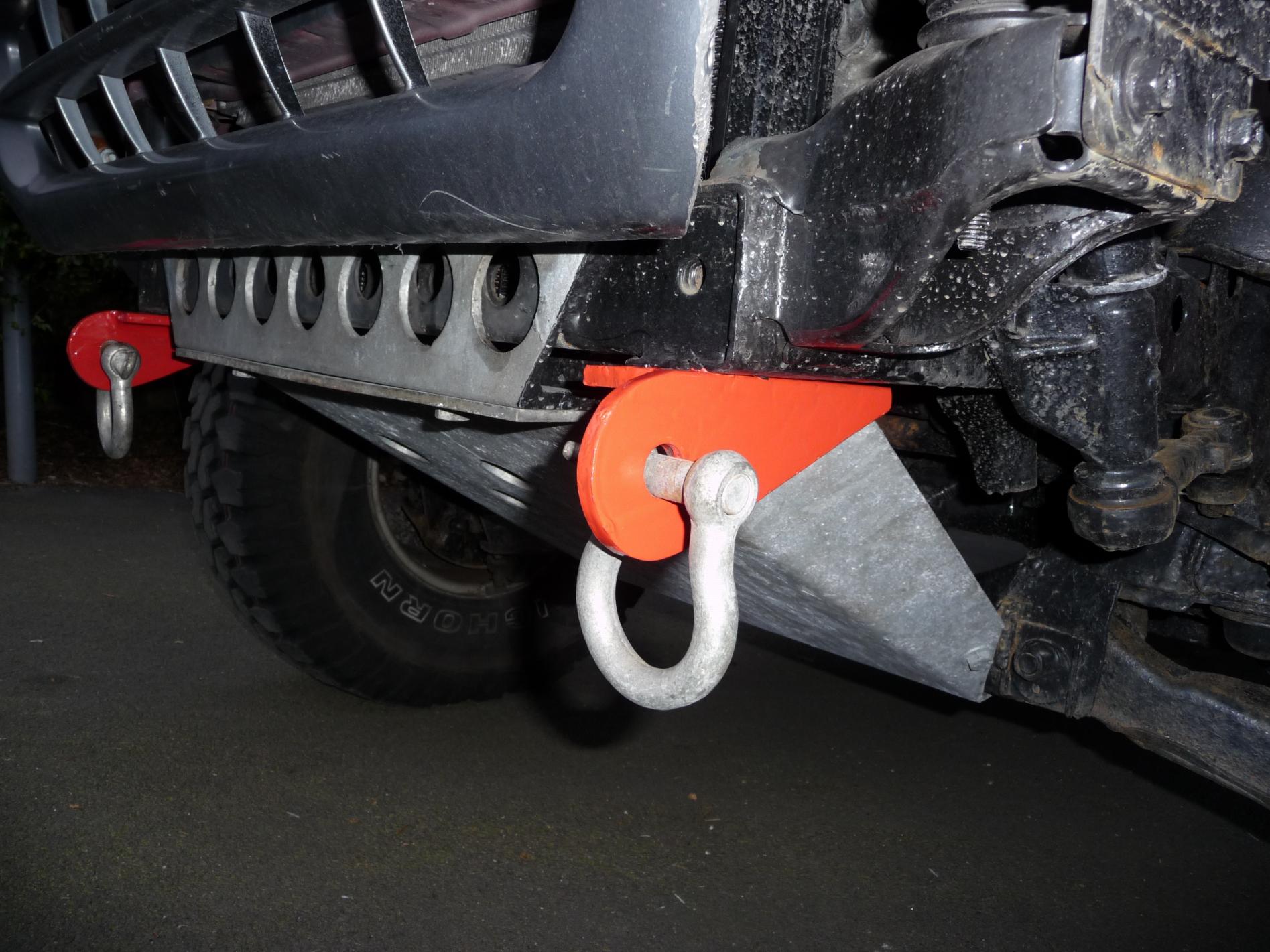

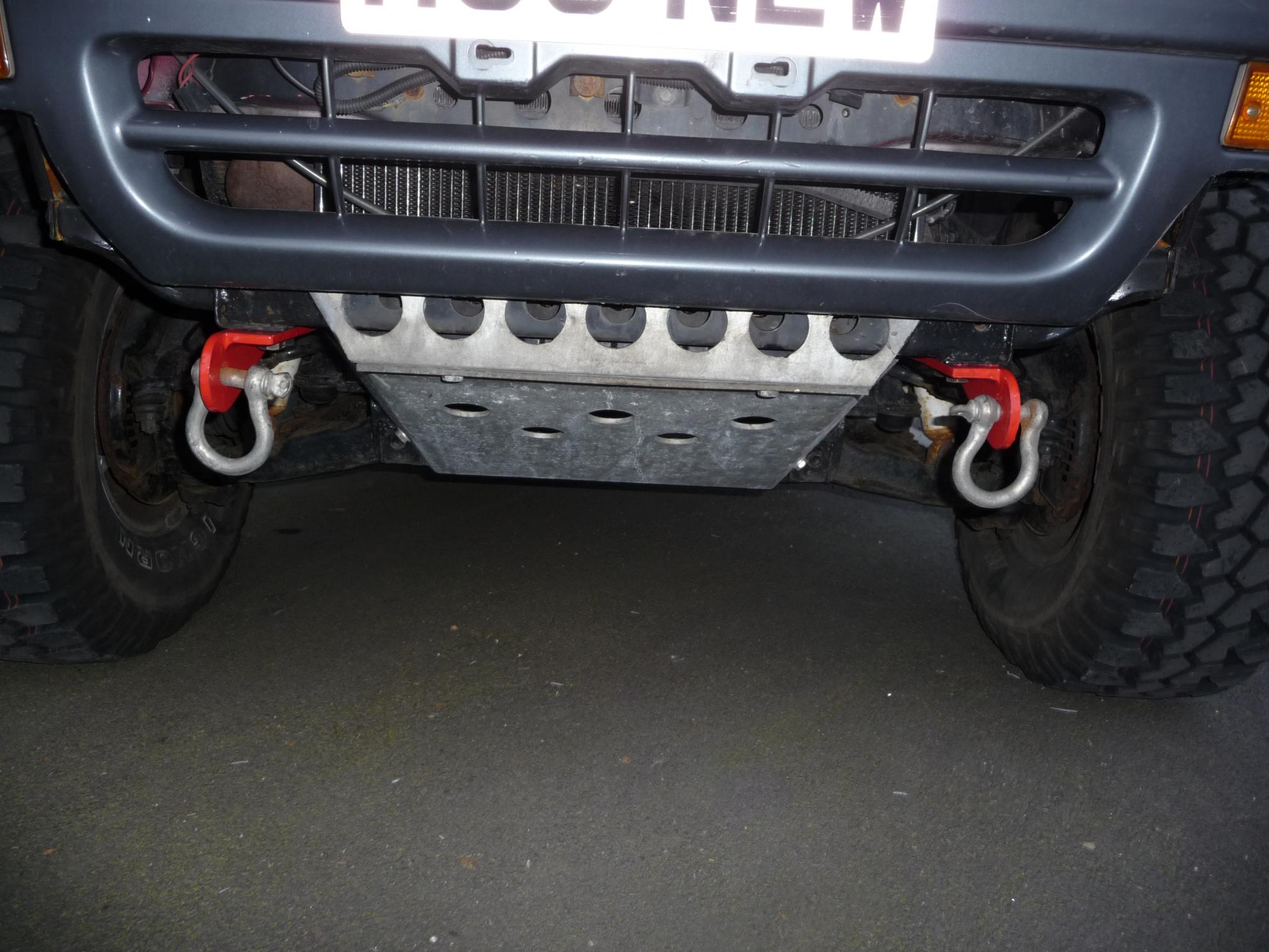

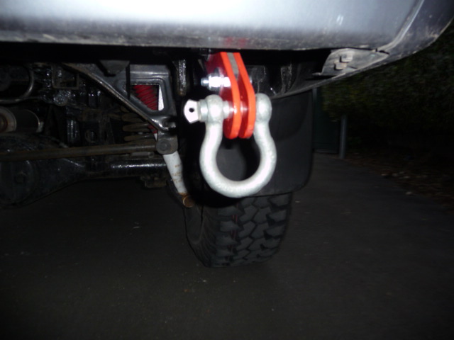

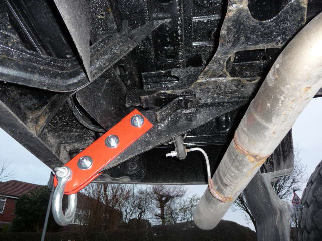

Just put these on. The seasoned off roaders amongst us will probably say that they're not strong enough for a really severe "snatch", but I suppose they're better than nothing, especially after I've welded in a cross brace to span between the two rear brackets. That should spread the load. (They are bolted onto the struts of the towbar, the rest of which has been removed.). The rear are 6mm plate, and the fronts are 50 x 75 in 8mm angle iron. I plan to re drill the fronts to set them back another 30mm. Here's a few pics.

 Those towbar brackets bend very easily... Not my truck I might add, but I saw one that had been bent just by towing with a rigid bar...
 Deffo good idea to cross brace them imho, other than that, looking goos Mick"B.A." Baracus: "Talk to me, talk sense so I can talk back. Not all this jibberjabber like breaking the peace and all that."

 Look great, Try welding some plates to make those rear arms thicker. I bent one of those when I bashed the tow-bar into hard ground. Where did you get them?

 Nice Mick, those fronts look perfect. You could always run a weld along where they touch the rail if you had any doubt.
 On the rear one way of adding loads of strength would be to weld plate on to pick up the holes in the chassis rail that the tow bar mounts utilise.Brian
 Thanks, Brian. I'll post a couple of pics when the cross brace is welded in. I'm hoping that that will stiffen it all up sufficiently. I think I'll redrill the the fronts, and set them back another 30mm, though.Originally posted by yoshie View PostNice Mick, those fronts look perfect. You could always run a weld along where they touch the rail if you had any doubt.
 On the rear one way of adding loads of strength would be to weld plate on to pick up the holes in the chassis rail that the tow bar mounts utilise." Time wounds all heels ".

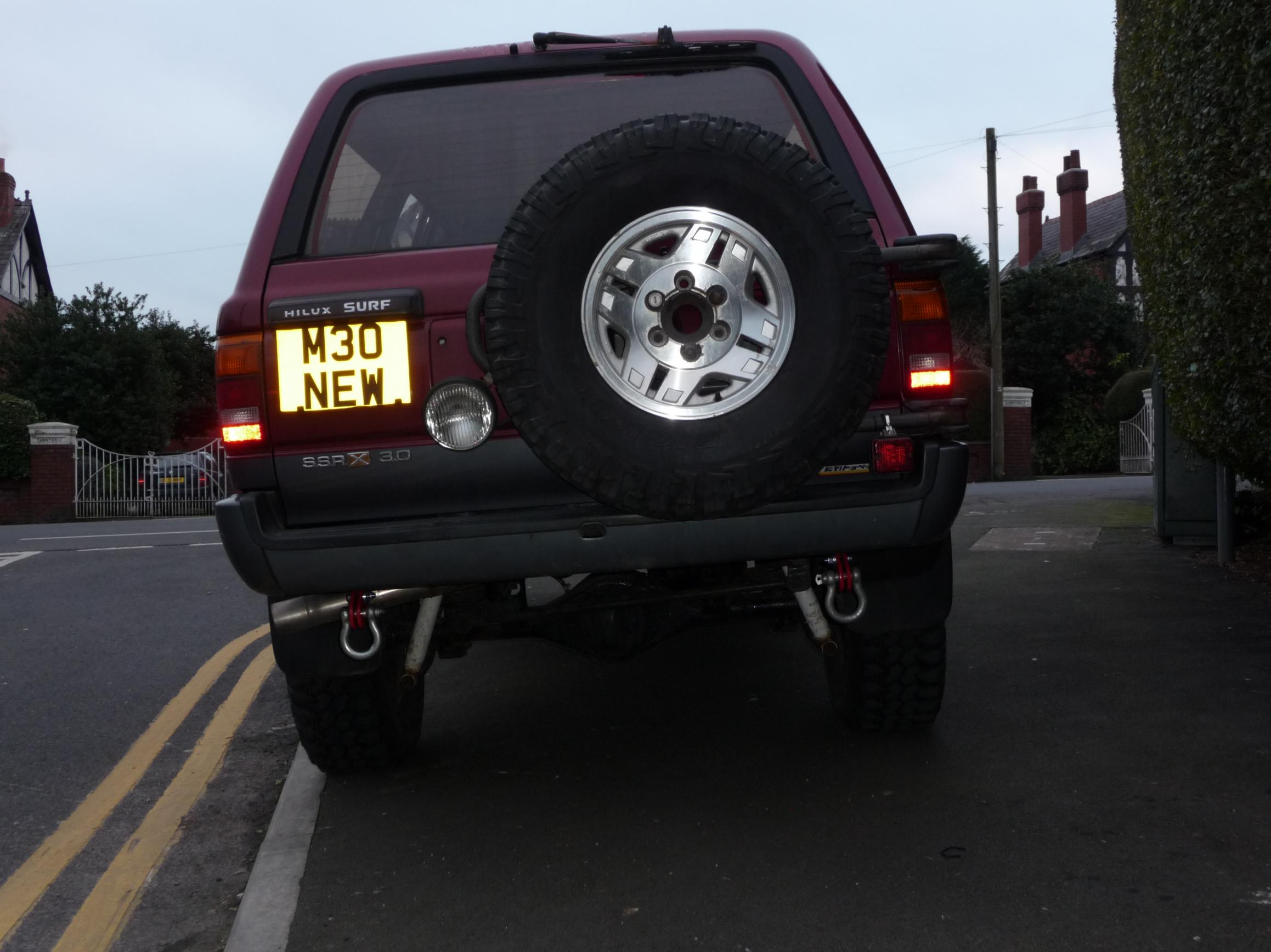

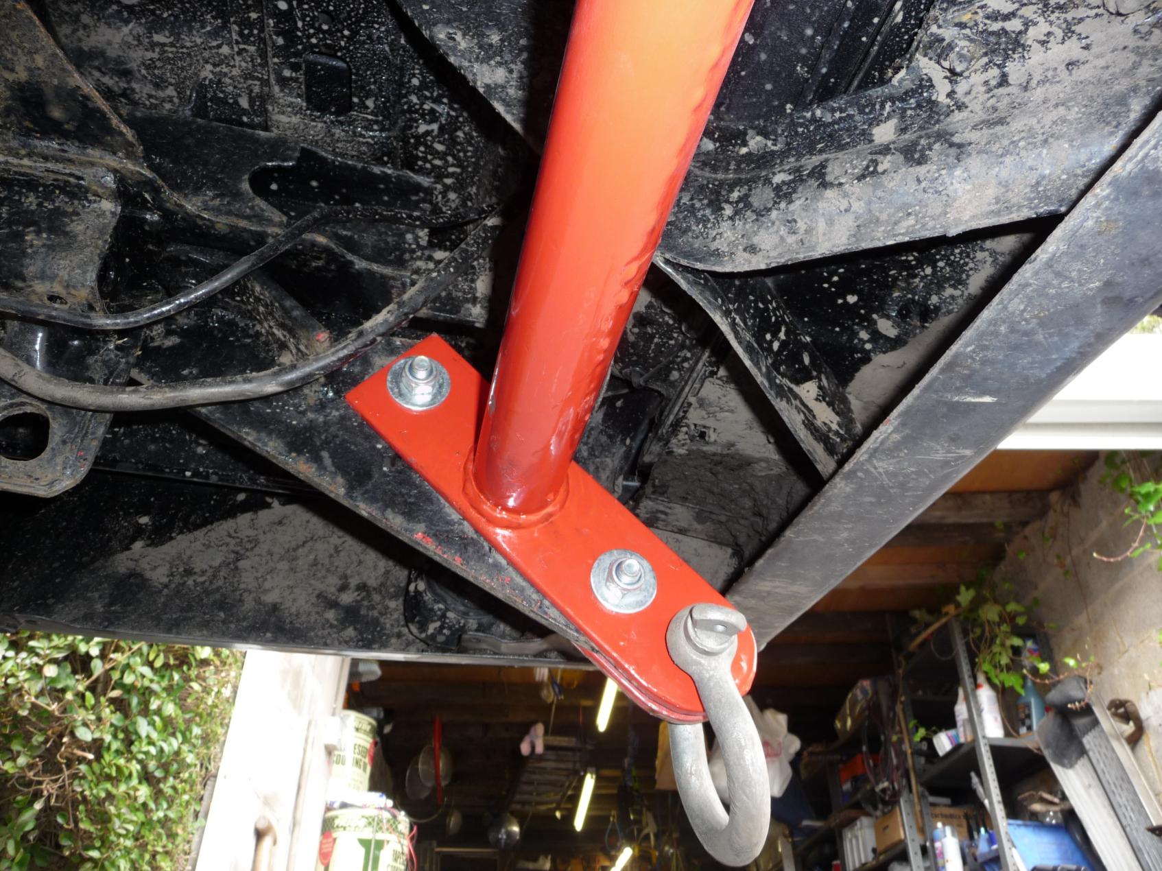

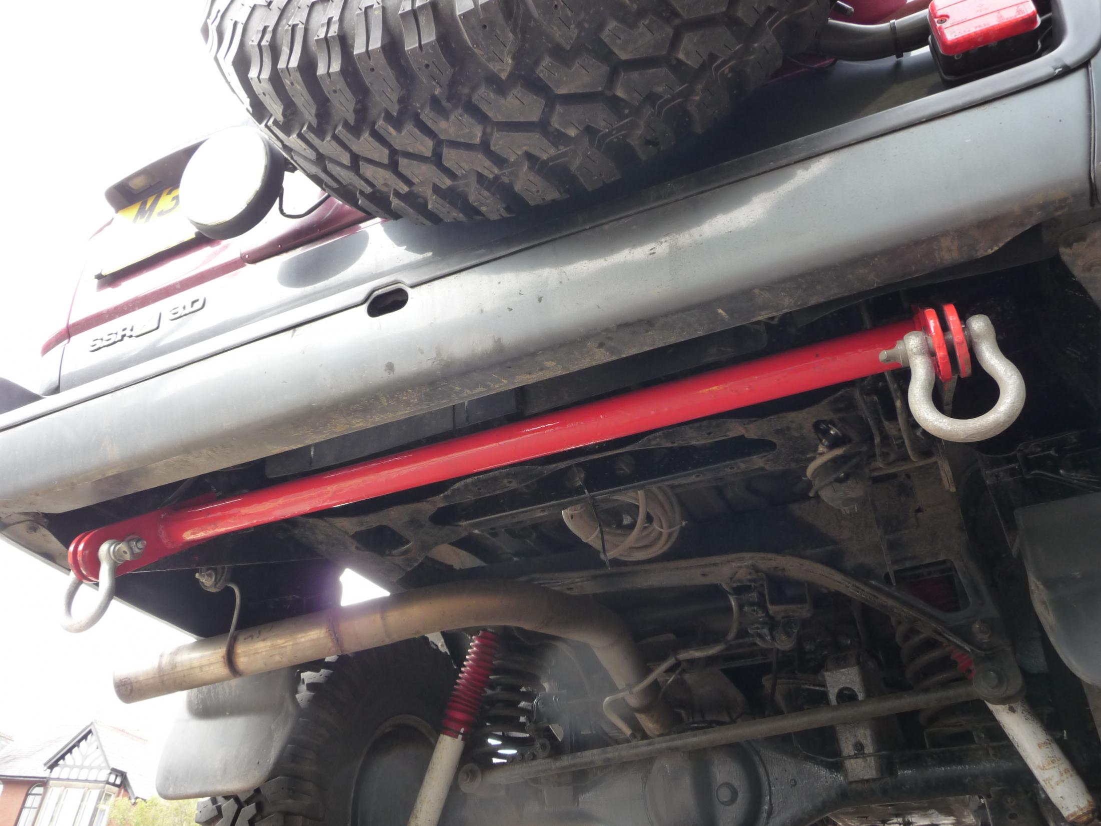

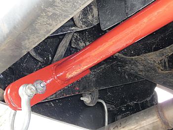

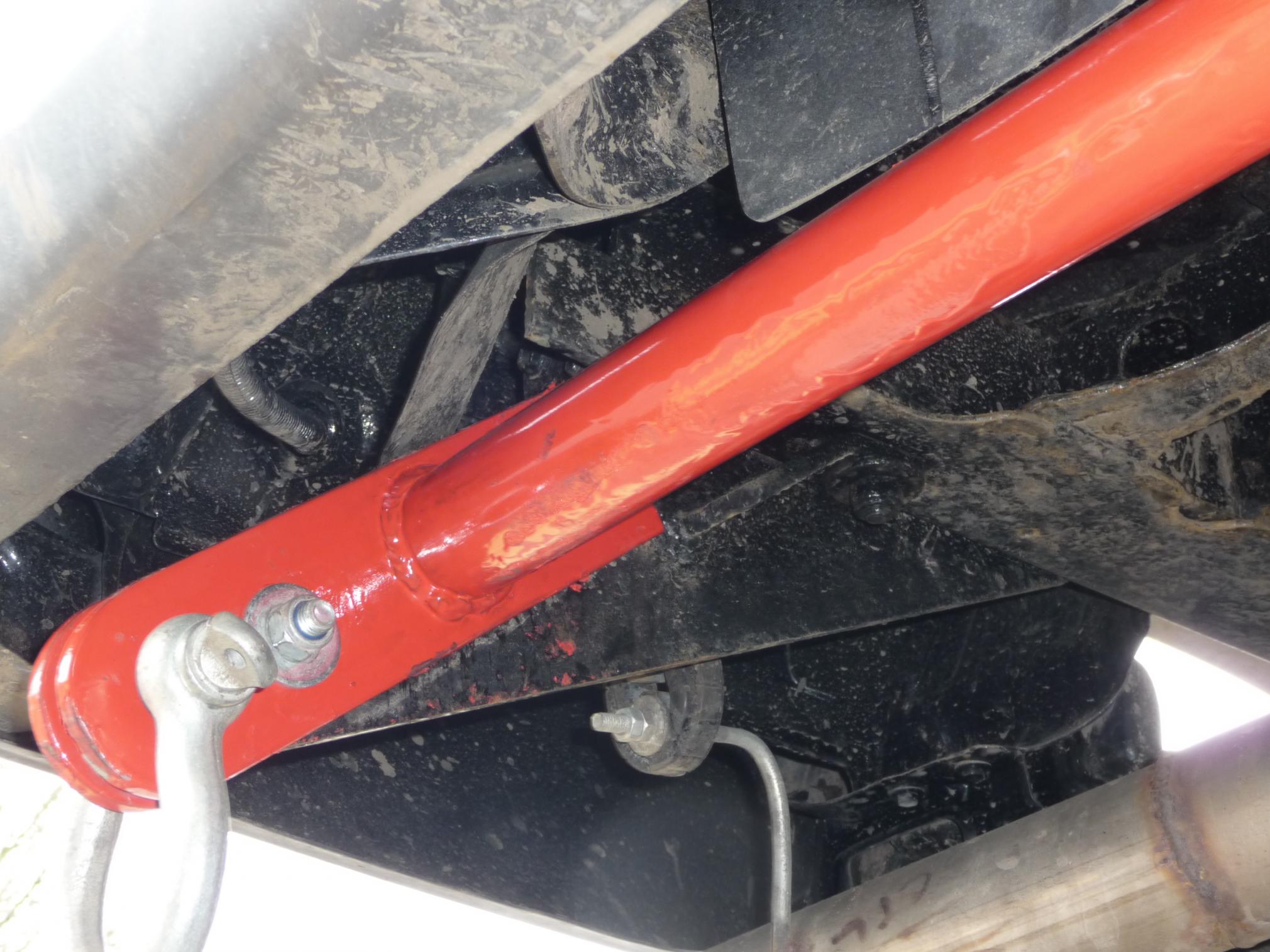

 Just a quick update on the rear recovery points. I picked up some scaffolding tube and cut it to length. A mate welded it between both sides as a good sturdy cross brace. It's now rock solid, and should handle any amount of recovery, even with a KERR. (Sorry about the poor quality paintwork)." Time wounds all heels ".
