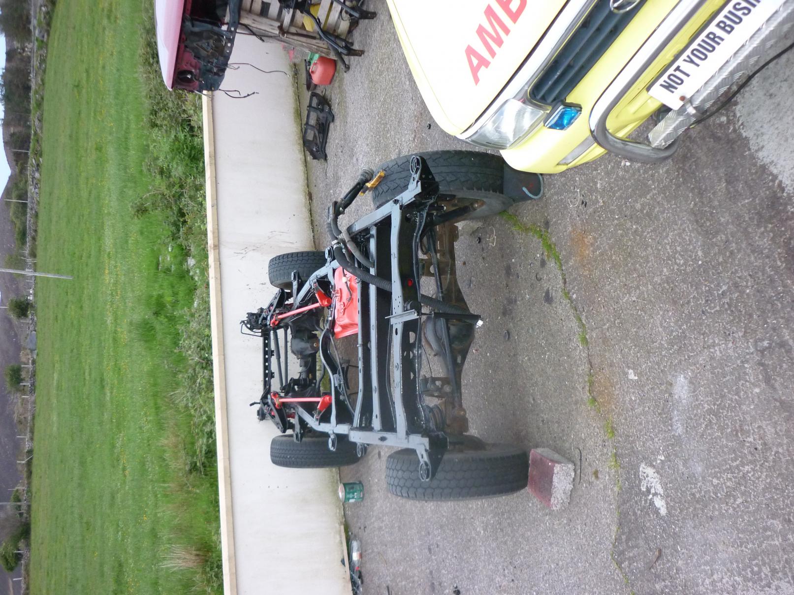

            • Chassis now black, rear Axel done, again in black. Tank guard, Transfer guard and Trailing arm guards all in red.
              New suspension parts still to go on and front wishbones to be cleaned and painted.
              Off to Aberdeen on Saturday to buy a car for my lad, so will lose a days bodging this weekend. I am getting close to the finish thou, so the project that was never meant to be a project might be road worthy soon.
              Brian
              • Only pic I have at the moment.
                Alan
                • Nice
                  I'm liking the guards, too
