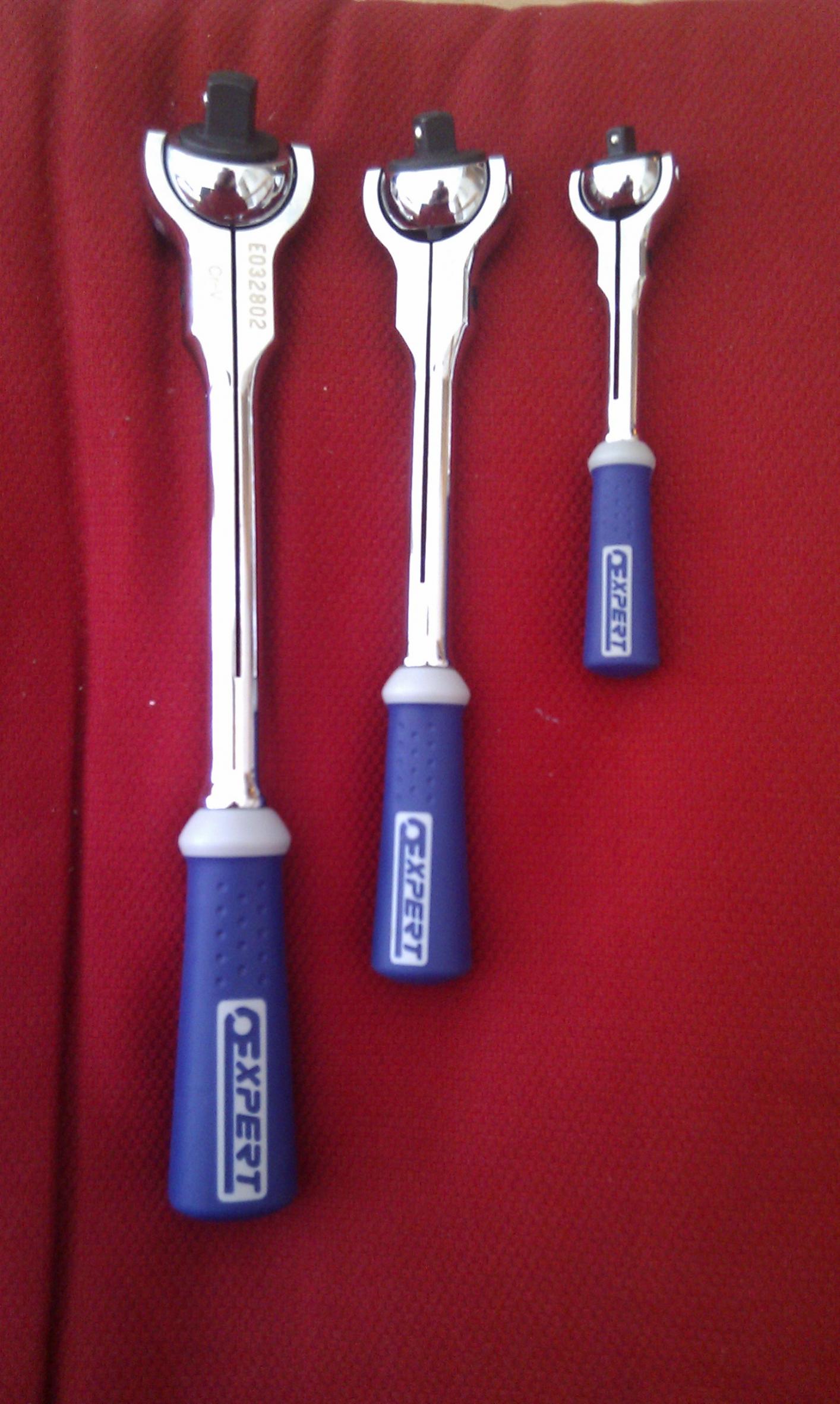

                  BTW new ratchets arrived.......SHINY!

                  • Originally posted by KERRSURF View Post
                    It's coming together now Bro, keep it up.
                    This post needed a picture.

                    • 1/4, 3/8 and 1/2 inch Britool swivel head. Built to last and easily serviced.
                      Alan
                        Very nice, now all I need is you to put them away clean when your finished with them
