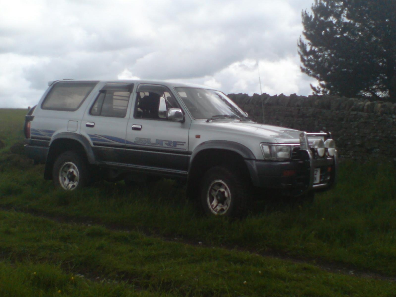

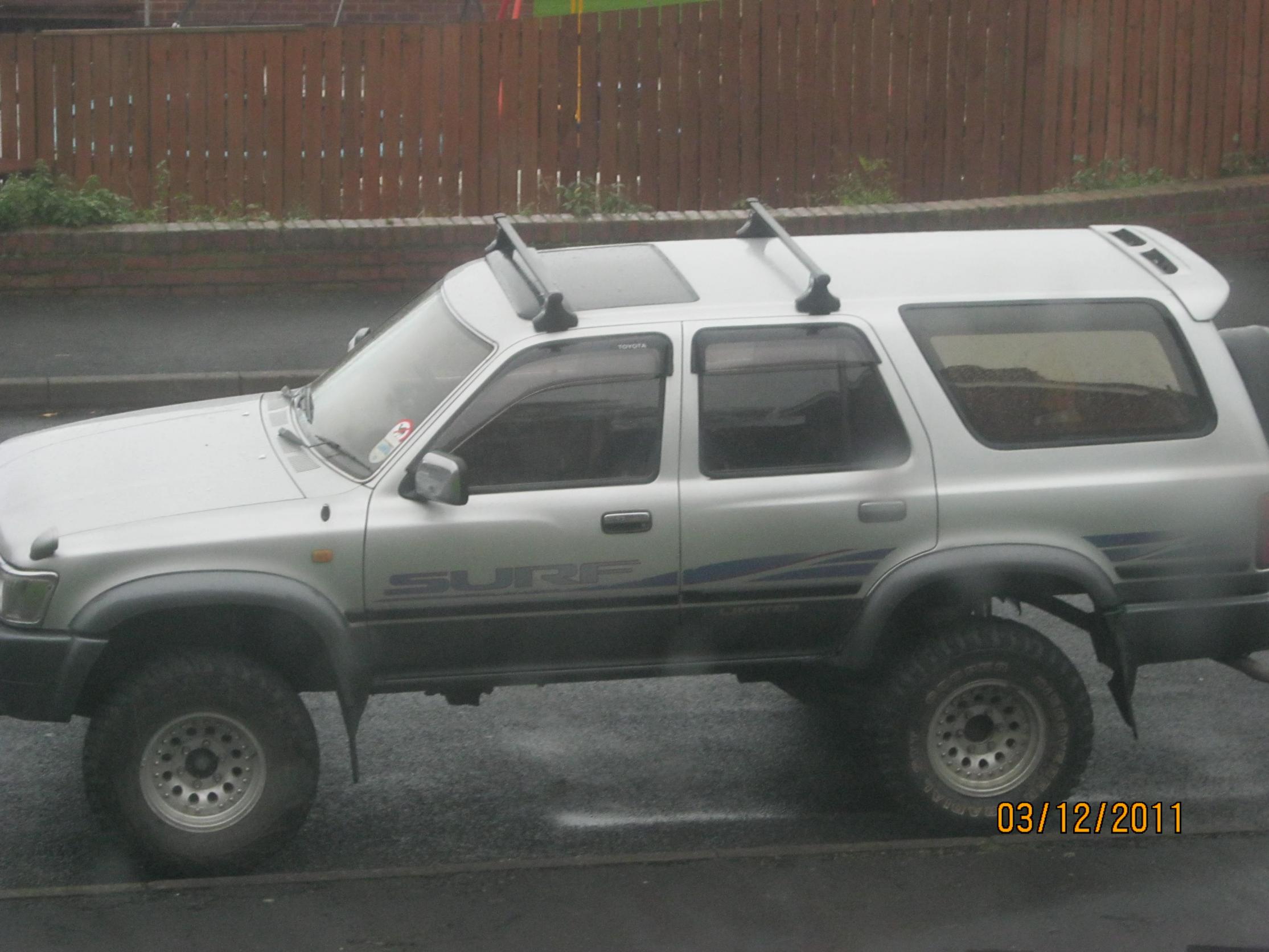

        heres mine when i first got it,and a one of how it is today
          I'm not one to mess around so I've done a 2" suspension lift and fitted 31" bf Goodrich mud terrains on aftermarket rims and removed anti roll bars an has made a hell of a difference. Where is best place for bumpers etc think that is next to get ordered.until I make the spacers for body lift. Thanks for the advice lads
